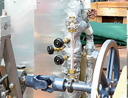

You should also put in three "Try Cocks" to test the boiler water level when the sight glass is out of service. Its sometimes difficult to change the glass when the wind is blowing and the waves are high.
For very small boilers I use 1/8 inch NPT radiator vents, but for a steam launch you can use small brass bar stock angle valves, commonly found with 1/4 inch OD tubing compression fitting outlet connection. A short piece of copper tube is fitted to direct the discharges to a safe point.
You could also use the fancy high priced ones, about $30 each at retail. I found the try cocks and sight glass (250 PSI ASME Rated) by lurking on e-bay. About $400 retail, bought on ebay for $65.
- Margaret S Water Column
- Boiler Column.jpg (27.02 KiB) Viewed 8813 times

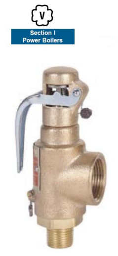

I need to look into safeties still but if someone experienced could tell me what size safety I need I'd very much appreciate it.
ANS: 1/2 inch safety connection is right. The smallest size will pass far more steam than your boiler will generate. Conbranco makes a 3/8 valve, but all the other manufacturers make 1/2 as the smallest offering, so use 1/2 inch. You can always bush down if you get a 3/8 valve.
