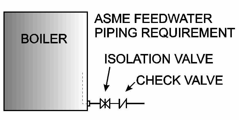

The ASME Boiler and Pressure Vessel Code requires an isolation valve, with a check valve immediately upstream for a feedwater connection. This single check valve is independent of any check valves on pumps or pump discharge headers.
The Code shows no examples where more than one feedwater connection is provided. I would guess more than one is permitted, although I see no real reason for more than one. When speaking of redundancy, how could this single feedwater connection fail, in such a way that an alternate feedwater connection would be used?

The rules say you must have an isolation valve and check valve on the pipe to the boiler, and is silent as to the valve arrangement upstream of these two valves.

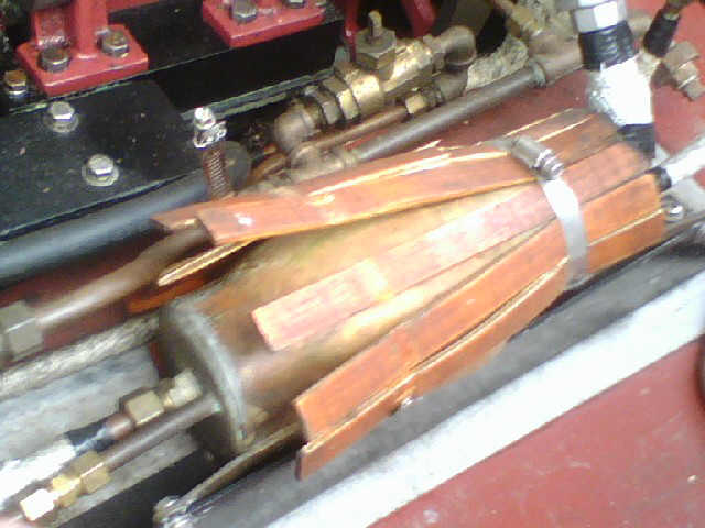

Remember to provide pressure relief protection if the pump discharge can be isolated, and the pump can produce pressures that exceed the design pressure of the piping. A small reciprocating pump that is engine driven can often produce enormous pressures, the one on the Margaret S. can easily produce way more than 2000 PSI if isolated. I have a relief on that pump. My manual feed pump can only produce about 500 PSI with me standing on the pump lever, so I don't need a relief valve on that one.
The attached picture shows a small steamboat feedwater heater that was isolated, and had no relief protection. The engine driven pump pressurized the feedwater side so high that it ruptured the tube inside the heater. The exhaust steam connections were also isolated, so the shell of the heater was then pressurized until it ruptured.

- ASME FEEDWATER CONNECTION MANDATORY REQUIREMENT
- FEEDWATER ASME.jpg (34.9 KiB) Viewed 8588 times
- FEED HEATER, 16 FT STEAM LAUNCH
- BLOWN FWH.jpg (38.29 KiB) Viewed 8588 times
