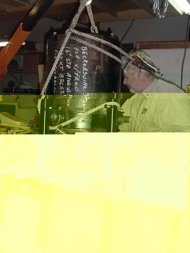

That surface area sounds about right. The attached picture is my boiler going into the boat, 16 inch dia x 18 inches high, very similar to yours.
The base is a 24 inch square steel plate, 1/4 inch thick. I welded pipes to the base for water cooling, but have not needed this as the plate only gets slightly warm after several hours steaming. On the plate is 1/2 inch ceramic felt insulation, covered with standard firebrick, above that is a stainless steel fire pot, with 4 inch diameter burner port welded in (I use a big propane torch for heat). The stainless steel pot has a bottom liner with another 1/2 inch layer of ceramic felt, and a stainless steel guard plate above that to keep flame impingement off the ceramic insulation.
I think if I eliminated the stainless burner pot and had a fire directly above (or on) the firebrick, things would get considerably hotter, and the cooling tubes on the base might require water circulation. With wood firing, leaving a small amount of fine ash on the firebrick (1/2 to 1 inch thick) would provide a considerable improvement in the insulation from heat getting to the base plate.
Den's placement of a water tank directly below the boiler is the best option, assuming no wood hull frames can get overheated by proximity to the base plate.

I going to pretend I didn't see those Vice Grips used to secure that rope.
