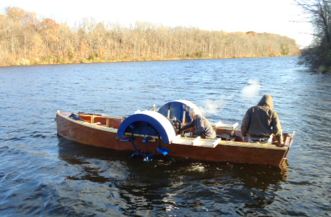

Rough Estimates, based on the 19ft - 6 inch plywood sidewheeler I built last year, which is covered in another thread on this forum:
Hull, 19ft - 3 in x 5ft beam x 24 inch debth. 1/2 inch mahogany BS 1088 sides, 5/8 inch mahogany BS 1088 bottom, Douflas Fir Frames 16 inches on center. This is probably considerably heavier construction than you are considering.
Plywood, 6 sheets 4 ft x 8 ft total, cost, delivered $425 USD
Epoxy RAKA slow cure, 9 US Gallons total, $450 USD
Fiberglass Cloth, 10 oz about $125 USD
Miscelaneous wood, screws, etc. say another $250 USD
Build time for the hull only, 2 months at about 4 hours per day for me, 240 hours, plus about another 50 hours from helpers., say 300 total
This was all done in a well equipped shop. Having the proper tools saves construction time.
I would guess the lighter boat hull, 1/2 inch bottom and 3/8 sides, 16 to 18 feet long could be built for about 60% of the numbers quoted above.
- SW-Leaving Dock.jpg (187.98 KiB) Viewed 8811 times
