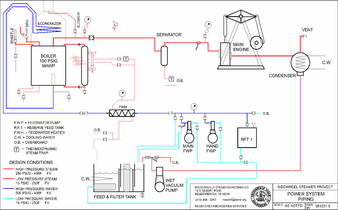

The stack causes a slight negative pressure in the furnace, and the stack draft can often be increased by use of a steam jet exhausting into the stack. "Induced Draft" fans are used in large plants to suck flue gas out of the boilers, but these are not a realistic option for a small launch steam plant.
A small (1 HP) non-condensing plant (atmospheric pressure exhaust) with 100 PSIG saturated steam (338F) will use about 60 Pounds Per Hour steam flow. Feedwater taken from the lake, at 70F, for a steam cycle efficiency of about 3.5%. Including typical small boiler efficiency of 70%, we have an overall plant efficiency of 2.5%.
The same machine operated condensing, (exhausting to perhaps 22 inches Mercury Vacuum) will need only about 80% of the steam generation, so overall plant efficiency goes up to about 3.1%.
Exhaust steam feedwater heating can be applied to either plant, however the non-condensing plant can heat the feedwater to about 200F, and the condensing plant can only heat the feedwater to about 140F, because it's exhaust steam is at a lower temperature.
Using exhaust steam to heat feedwater, the non-condensing machine can reduce boiler heat duty about 11%, resulting in an overall plant efficiency increase from 2.5% up to 2.8%. For the condensing machine, the boiler heat duty can be reduced by only about 6%, so the condensing plant efficiency increases from 3.1% to 3.3%.
The feedwater preheat coil located in the flue gas downstream of the boiler section is called an "economizer", and is used on almost all larger plants. By supplying extra heat transfer surface area, overall heat transfer efficiency goes up and less fuel is required.
Assuming the economizer heats the feedwater up to 300F, the boiling section heat duty goes down:
For the non-condensing plant with no exhaust steam feedwater heater, about 20% fuel reduction is achievable with the economizer, overall efficiency goes from 2.5% up to 3.1% This economizer has to have the largest surface area in this comparison.
For the non-condensing plant with an exhaust steam feedwater heater, about 10% fuel reduction is achievable with the economizer, overall efficiency goes from 2.8% up to 3.1%. This economizer has the smallest surface area in this comparison.
For the condensing plant with an exhaust steam feedwater heater, about 15% fuel reduction is achievable with the economizer, overall efficiency goes from 3.3% up to 3.9%.
These numbers are only approximate, and one can study the extra cost of various economizers and feedwater heaters compared to fuel savings for a large number of options to attain the true optimized design.
There are other "tricks" that can be used to increase plant efficiency, such as superheated steam, compound expansion engines, uniflow engines, special valve gear, etc. Feedwater heating with exhaust steam and economizers are two components that can be relatively easy to retrofit on a small launch plant. As always "every stick has two ends", and there are extra costs, extra maintenance work, and operating restrictions that come with these modifications.

- Cyc05b.jpg (86.7 KiB) Viewed 7217 times
