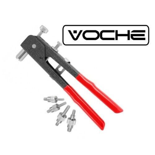

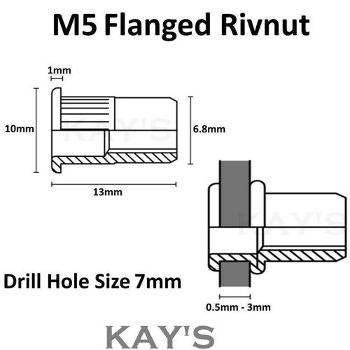

However, as always the internet is keen to sell me stuff and I have been introduced to the Rivnut which seems to do the same as the Hank Nut but rather more cheaply. It seems the underlying technology of the rivet is the same, but Rivnuts are much closer to the pop rivet with which I am sure we are all familiar. Just in case that has passed you by this is what the vendor(s) showed:
There are also hand tools to compress the nuts that are offered at a very low price (£8.42 GBP) and with mostly good reviews. I suspect that they are made in China under questionable working conditions so one might or might not get a good one.
So, that is a possible alternative for those of us with somewhat lower standards in our making.

I notice that, in the case of the Rivnut, it protrudes 1 mm from the surface. This may or may not be an issue with your application. Are air leaks a possible problem?
