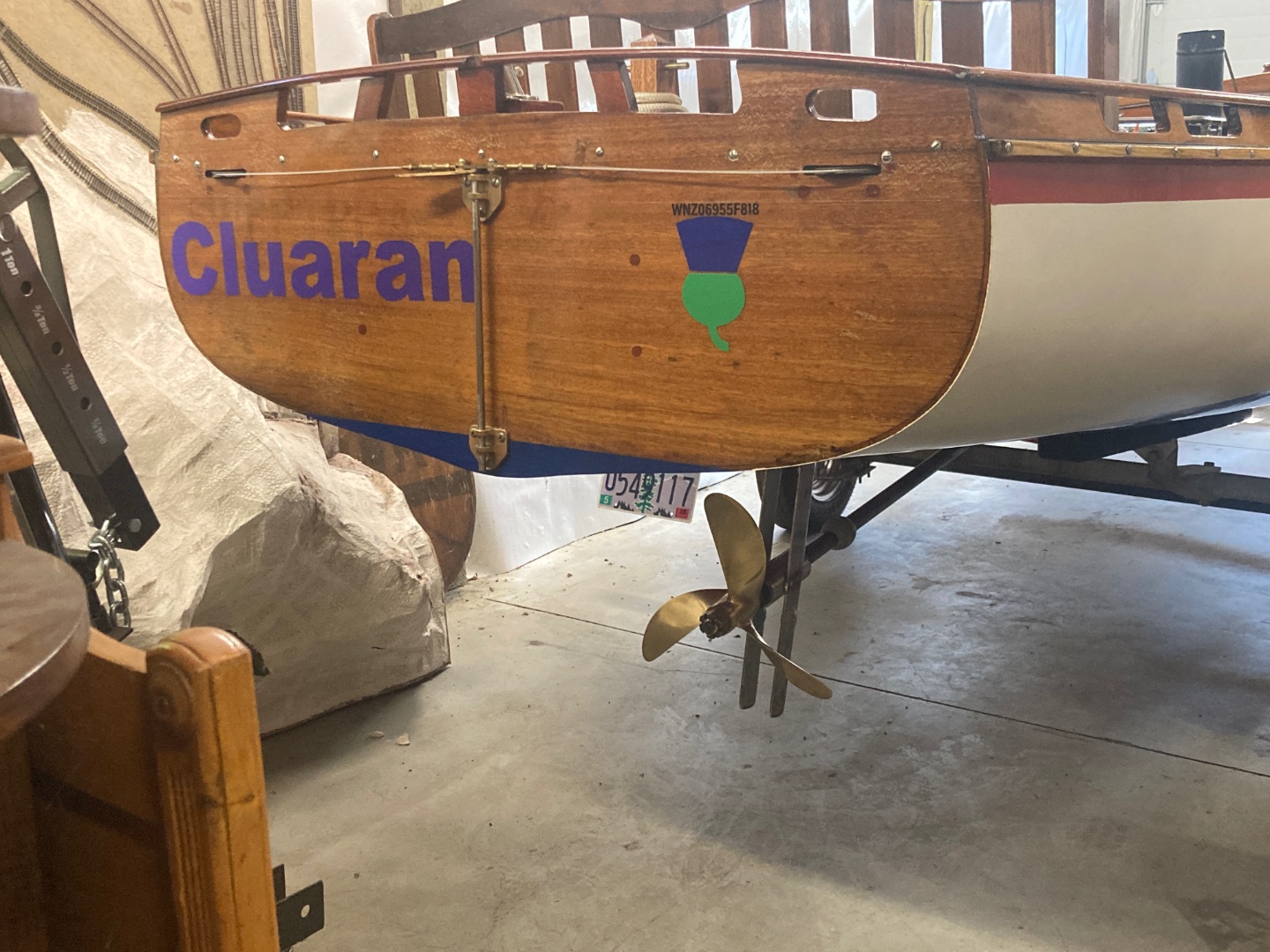

Finally (!!!) today I finished installing the new prop on Cluaran. This project only took 1 year from beginning searching for a classic prop casting,
then finishing it, and finally fitting it. Had to R&R the shaft threads and make a new key. It all went disturbingly well.
Next are more performance tests. Date unknown. Here's hoping...

Well done Russ
That looks fabulous and from all you have reported it sounds to have been installed with a high degree of precision. I hope that you get a chance to try it out soon.
