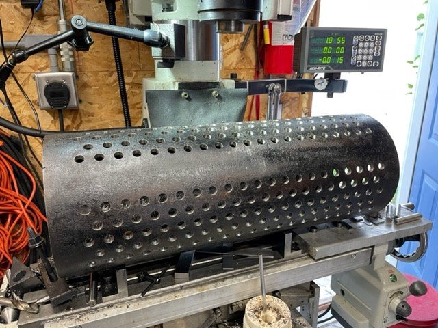

Just a quick pic to get the board traffic up, it's been a bit quiet lately.
Center drill, drill, ream, repeat 206 times. Each series of holes required moving to clear the end of the tube so as to be able to change between center drill & drill and also to change the drill chuck for collet & reamer. Used every bit of the vertical, even with the 4" riser" for the reamer to clear the tube. Was only able to do about 2/3 of the holes in a row due to length of the X axis travel. Once all of the reachable holes on one end were done, flipped end for end then picked up the last hole to complete the remaining holes in the row.
Now on the the mud drums, which should be easier since I should have enough room in the Z to use the longer keyless chuck for all of the operations.

Ouch - that takes some patience; at least you have a power traverse :). I remember doing the same for Otter's boiler (well, it was only 110 holes iirc ) 27 years ago on a mill-drill. I had a very stubby 5/8" drill Latrobe drill bit that saved the day wrt clearance; putting the drum directly on the table and nestling it into a slot helped as well. W/o a DRO, I center-drilled, pilot hole and then the 5/8" hole in one position, so my fingers and the chuck key got a work out.
Nice work! I look forward to seeing your boiler take shape.

Since the tube is offset along the X and the end is beyond the slots of my table I needed to use the extension plate that you can see in the photo. To reduce the need to indicate for each row of holes I made a set of "V blocks" and the V-blocks also gave the clearance needed to fit the extension under the tube end. I was expecting I would probably needed to trim the shank of the reamer, but there was just enough clearance for the reamer to clear the tube but couldn't swap tools without going to the end.

That's a lot of drilling and reaming. All tubes will be rolled in I assume.
Is your boiler following your own plans? How many square feet of heating surface are you looking to achieve? Any drawings we may peruse?

Yes, Tube will be rolled in. Purchased a tube expander from Wicksteed in the UK as they were the only ones that offer an expander for 1/2" tubes and not too long to fit into the 4" mud drum. (Still may have to trim a mandrel to fit)
Using John King's boiler as a guide but have changed from Cunifer tubes to steels tubes and worked the math to ASME code. Copper alloys are problematic with ASME code and the grade needed aren't available in the states. Several suppliers list them, but they are not available in quantity less than a mill run, or in the grade or size needed. Since the Cunifer tubes wouldn't have met code and were unavailable anyway, the decision was made to go with steel tube. The steel tubes were difficult to get as well and while they don't meet ASME code they are a hydraulic tube grade that is materially the same as A-179 boiler tube. It's the same tube that some of the Stanley guys are using to tube their boilers. Otherwise, the remaining materials are all code listed but the boiler won't be to code due to the tubes.
The heating area is 39.9sq ft based on tubes only, but I expect the steam drum doesn't add more than another square foot to the total as not much is exposed to the firebox radiant energy.
I have been working directly from the CAD model so don't have a set of drawings per se. Working on the sheet metal for the casing so don't have the spare time to make drawings at this point but I'll contact you in private.
