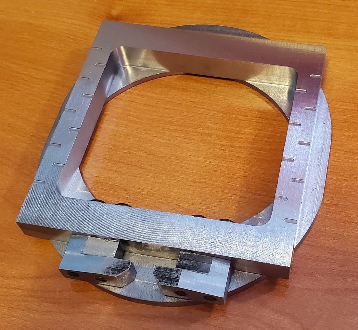

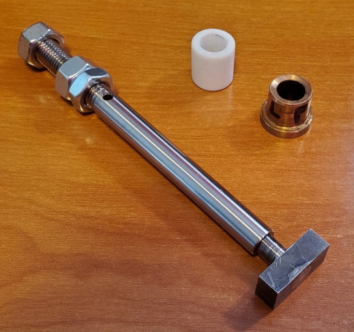

Post by Kelly Anderson »
The original low-pressure slide valve in my launch engine needed to be replaced this spring due to heavy wear in the cast in T-slot that connects it to the valve stem, so I hogged the new one from G2 cast iron plate, and to assist with potential wear on the bottom faces of the T-slot, I made those pieces and the block at the top of the valve stem from 4140 steel. The valve stem is Monel.
The dead-end shallow slots along the sides of the valve seat are a feature sometimes seen in locomotive slide valve to allow oil to reach these normally dry areas of the valve.
This engine uses inside admission slide valves, the only time that I have ever heard of such an arrangement. To hold the valve against the seat, a generously sized, spring-loaded balancing piston is provided. As I have said, the designer of this (originally an automobile) engine threw every far-out design feature that he could think of into this project.
New valve stem

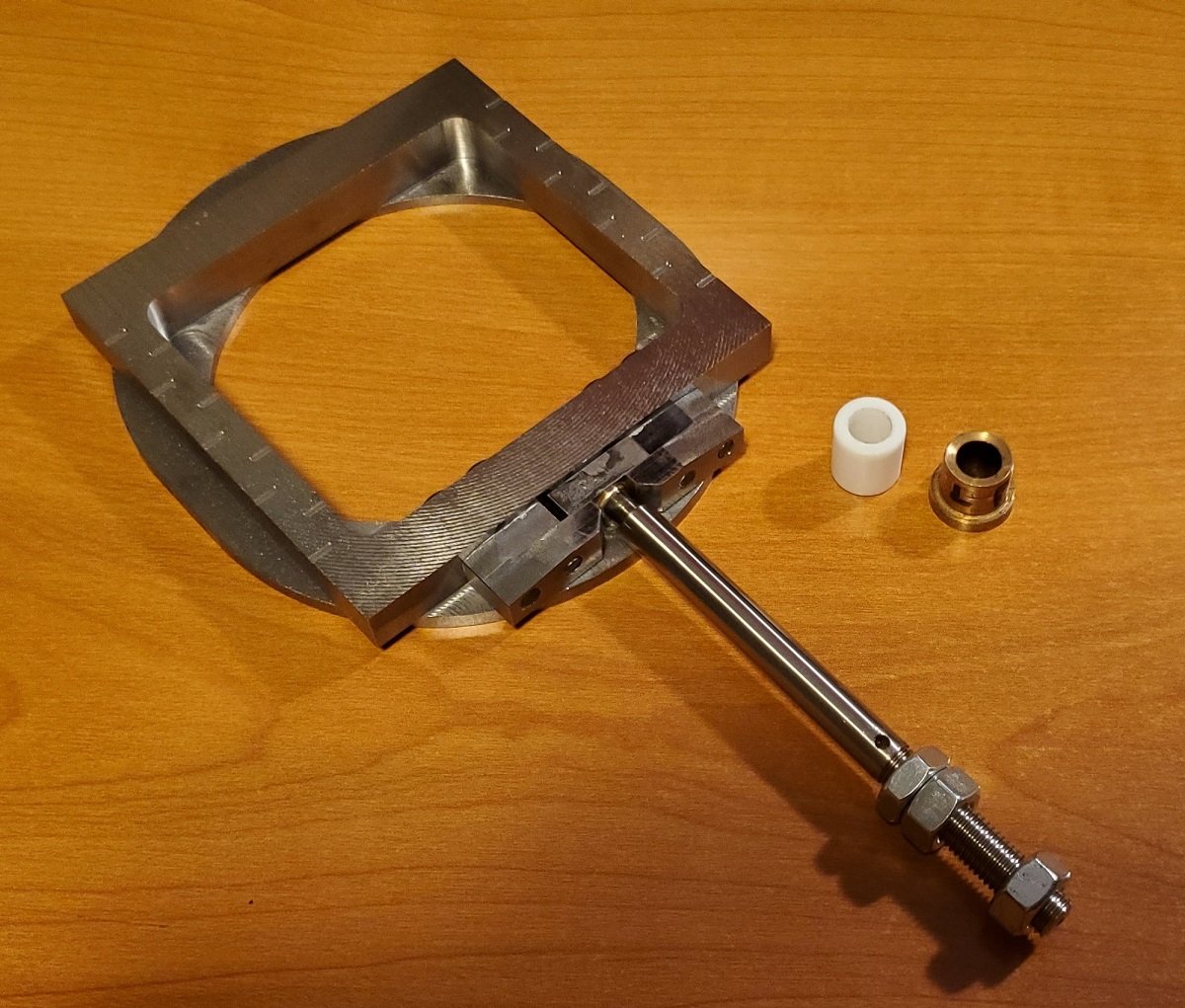

New valve assembly
Balancing piston
valve installed and set.jpg (102.08 KiB) Viewed 43166 times
Valve installed and set
Re: A Funny Looking Slide Valve
Excellent work, as usual from you. The oil slots on the slide valve is new to me, although I have only been involved with the study of steam engines for 70 years now.
