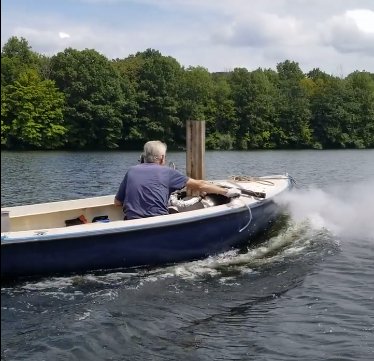

Yesterday we launched this 14 ft boat with a new oil fired monotube steam generator, for a preliminary shakedown cruise. Steam is raised quickly, about 30 seconds for steam pressure to start building up, about 2 minutes to reach 145 PSIG (10 Barg). Poppet Valve Uniflow engine worked well, driving the boat at 5-6 knots. Engine vibration is a problem at around 700 RPM. I may need to change gearing to get around 1000 RPM, I know the engine is settled down at that speed.
A few initial problems that will be relatively easy to fix, the motor driven feedwater pump kept unloading, so we had to use the hand pump. No exhaust piping on the engine, and no tall stack on the steam generator, so Mark and I suffered with steam, copious amounts of heat/humidity, as well as oil burner fumes. That will all be corrected before next running.

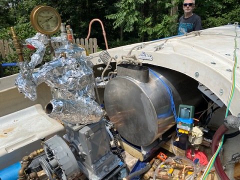

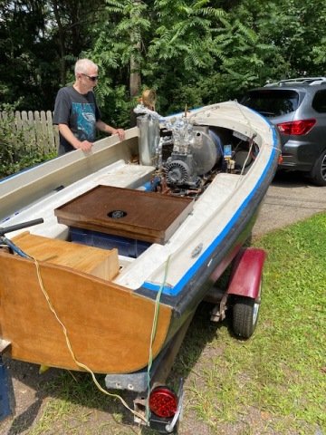

Very crowded arrangement under the forward deck, containing Generating Coil, 120VAC Oil Burner, 12VDC-120VAC inverter, fuel supply and return hose, with large filter, letdown heat exchanger coil, (40 feet of tubing), burner pressure switch, letdown overboard discharge valves, separator thermodynamic steam trap to backup letdown flow, feedwater flow lines,one direct into generating coil, other thru the letdown heat exchanger, stainless flex connection from generating coil to separator pressure vessel. Small electric diaphragm pump, with manifold allowing lake water boost into feedwater pumps, or alternately can be valved as a bulge pump. Crowded but still easier to work on than the engine compartment of a modern automobile.
Just aft of the deck, separator vessel with relief valve and several other connections, uniflow engine, with roller chain drive to propeller shaft, motor driven feedwater pump, hand feedwater pump, stainless flex connection to engine, steam isolation valve, engine throttle valve.

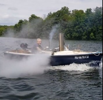

Lake Noximixon Steamboat Meet 14 Aug 2021. Had the new boat underway, a nearby steamboater took some moving pictures, on facebook "fredrosse". Everything worked as designed, but still a little rough around the edges.
Technical details for first running: 125 PSG (8.6 Barg) steam, 62kW Firing Rate, making 6 knots with a 350cc Uniflow engine at 700 RPM, prop at 525 RPM.
Design will eventually run at 250 PSIG (17.2 Barg), 125kW Firing Rate, making a little over 10 knots with a 1000cc three cylinder engine at 1000RPM engine & Prop. To quote from a relatively famous movie: "You're gonna need a bigger boat"
