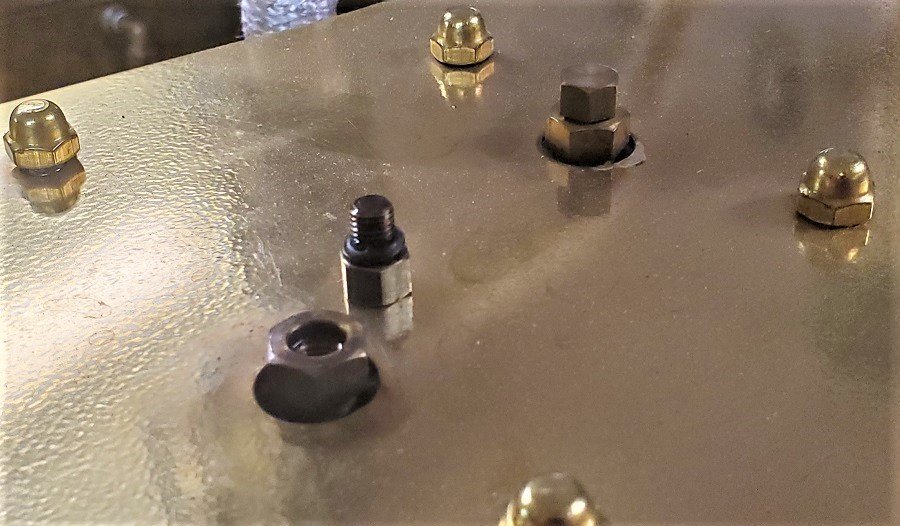

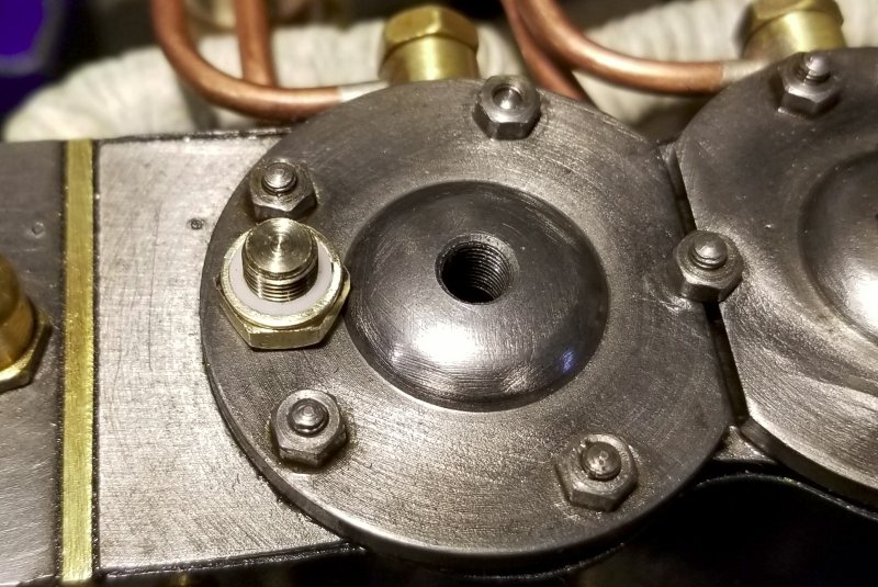

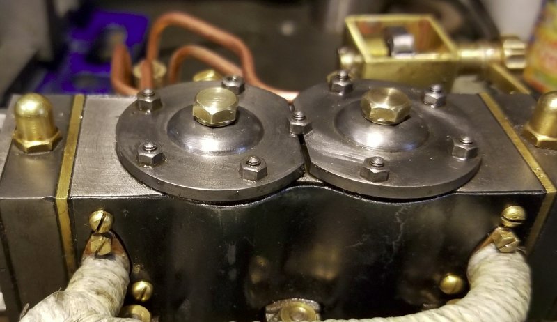

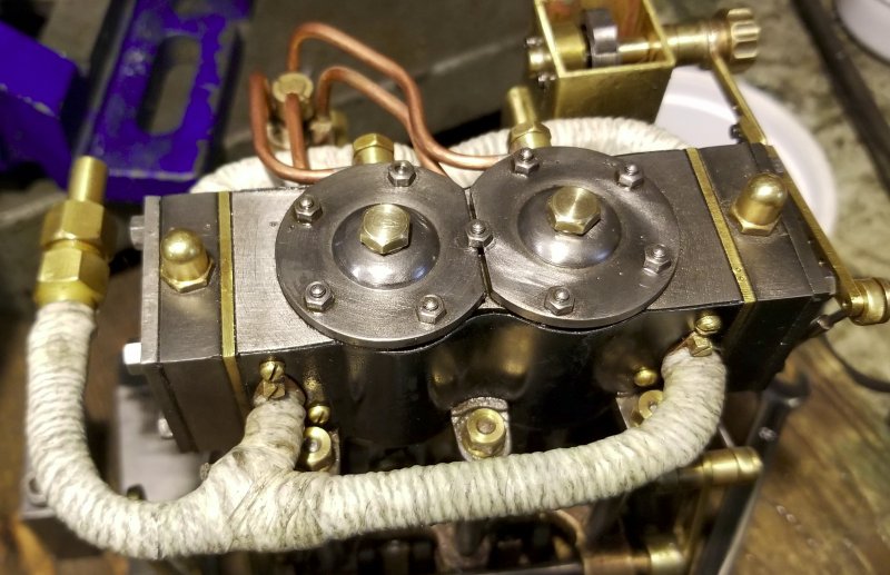

Hi,
my little STUART Launch twin need an extra drip of steam oil into the cylinder after running, but there was no possibility to do it. So i drilled through the cylinder cover and cut an M5x0.5 mm thread.
While running the engine it is closed with a hexagonal bolt with a special TEFLON seal. This is supported on the outside by a brass ring that is slightly flatter than the seal. It ist steamtight and it is possible to open by hand after running.
Some pics.
Best Dietrich
