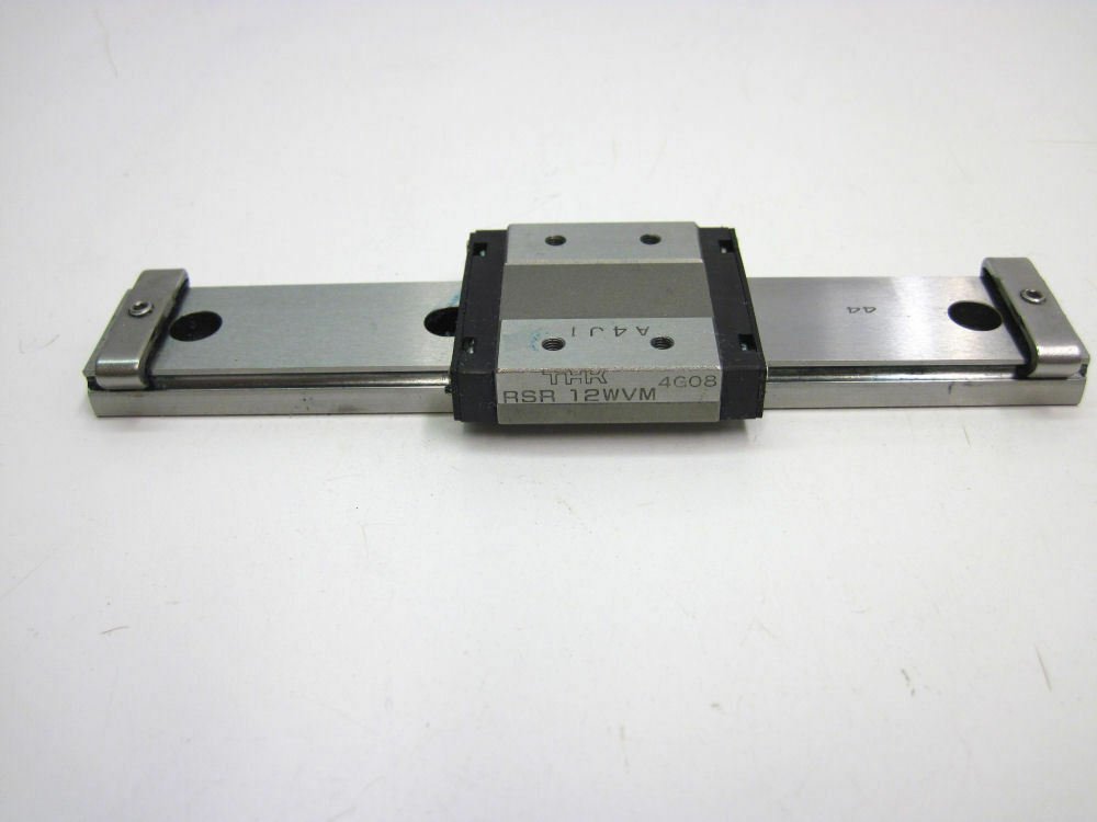

I've seen machinery that was designed that way and always wondered if it would wear evenly along the guides. I guess that's just as much of a problem with a sliding contact.
But wouldn't the guides that the ball bearing run on need lubrication anyway? Unconfined oil and grease is what I'm trying to cut down on.
Re: Con-rods and length
Linear slides with ball bearings need components that are hardened and ground like any other bearing race. In a reciprocating configuration there needs to be space for the balls to travel and roll about their path. Balls that drag in a race instead of roll will wear unevenly and quickly.
Ball bushings for linear traverse use a recirculation tube to keep the balls rolling and prevent them from sliding. A bearing with a fouled recirculation tube and balls that improperly slide instead of roll will fail in short order. Any linear ball bearing sliding component will have wipers fitted to remove foreign debris in the path which can easily lock them up.
Any sort of circular component to heel forces is going to have a very small point of contact which bears the whole load which would be evenly distributed between two large planes as in a conventional crosshead design. So those surfaces need to be as hard as the balls. Hardchroming is only as good the material it is on.
If you want a low maintenance ball bearing linear component thats clean and capable with a very long service life, that would be the THK style rail and car/guide system. They have a recirculation circuit as well. Just shoot em up with heavy grease occasionally.
