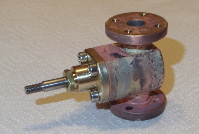

Hello,
every engine needs an throttle valve, so i have asked my library. I found two different solutions, a piston valve (STUART Undertype) and a slide valve (Navy K engine). The advantage of a piston valve is that the actuating forces are independent of the effective vapor pressure. That's why I chose it.
The valve body i have built from three gun metal parts, they were silver soldered.
The soldered valve body.

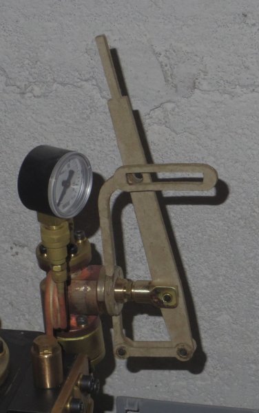

Hello,
to be sure that the measurements are correct and the valve actuation works as desired, I cut out the parts with the cutting plotter and built the quadrant on a trial basis.
The result can be seen here. I am satisfied and will now have the parts laser cutted.
Throttle valve - lever in closed position
Throttle valve - lever in position "full throttle"

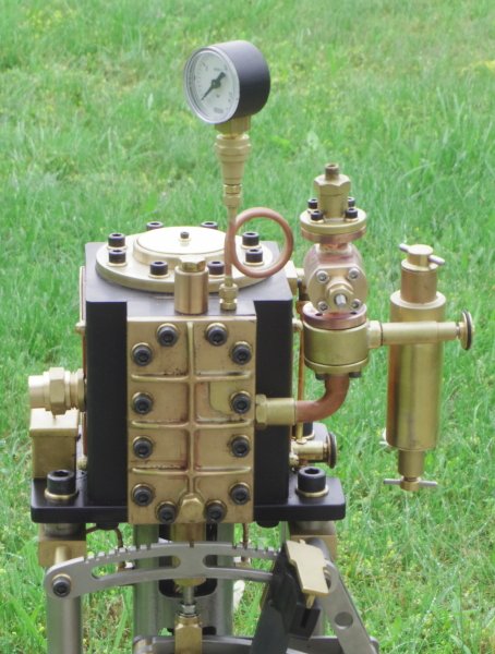

Hi,
the throttle-valve is finished. I installed a cover plate in front of the quadrant so that it looks more pleasing.
before
before
after
after
I also installed a connecting rod between the valve and the cylinder, so that the valve is secured against twisting.
