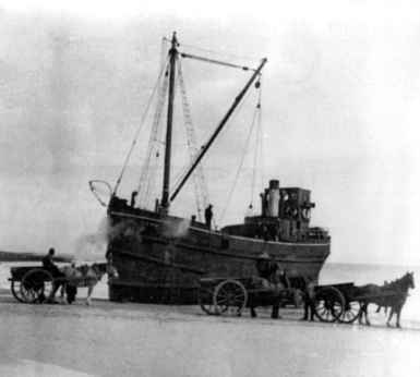

Depending on the weight of the crates, he may want to make the cargo boom ready to hoist the crates overboard. On this little steamer, the cargo boom would also be the sailing boom, rigged for either duty.
The old steam puffers show the boom arrangements, and they would generally beach the entire boat, at low tide wagons could be brought along side for loading, then high tide would allow steaming away. The steamer of your story is far smaller, and your cargo boom could probably let 200 kg crates of the bow, but not that heavy over the side if you are afloat. Being grounded and waiting for the tide may not be an option in your story.
How hi-lo tide change in elevation in the area you are writing about??
