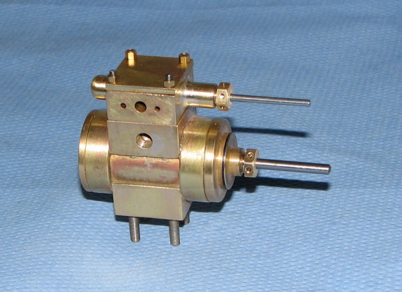

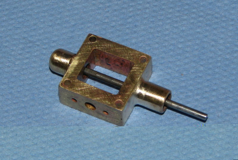

Hi Bart,
i prefer gunmetal for that part. The valve rod should have a small flat part a bit longer than valve stroke to prevent it from vacuum in the chamber above the rod.
Here some Pics.
The Valve rod
Valve rod in place in valve chest
complete cylinder
The running engine - my little steam logging loco
Best Dietrich
