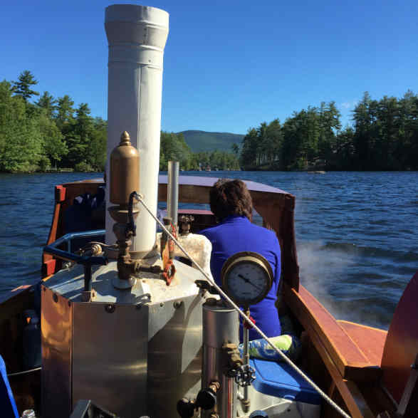

Virtually any grade of stainless would be more than adequate for stack service. For stack gasses below about 700F, ordinary steels are fine, and much less costly. The ASME Boiler and Pressure Vessel Code allows virtually all common steels up to 650F, and only temperatures higher than that result in a reduction of allowable stress. With a reasonably efficient boiler, stack gas should be below 650F.
For the last several years I have been using an ordinary galvanized stove pipe section, which takes high temperature paint very well after the shine of the galvanized surface is heated with a big torch, to simulate a couple of years of weathering. Without this heating the galvanized metal surface will refuse to allow good paint adherence. My stack temperature is only about 410F, but the paint I use claims service to 1200F.
- MS Stack.JPG (34.22 KiB) Viewed 10171 times
