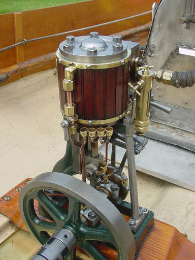

How many oil cup lubricator are there in a full set?
Regarding engine driven mechanical pumps, please excuse the rather dumb question, but are they an independent unit or are the attached to the engine itself?

Re: Engine specification advice please
How many oil cup lubricator are there in a full set? ANS: See attached picture of a Stuart No 1 in a small steamboat, a good example of a reliable engine setup.
Regarding engine driven mechanical pumps, ... are they an independent unit or are the attached to the engine itself? ANS: Some drive a small reciprocating pump directly with an eccentric on the crankshaft, but the high speed of the engine (500 RPM +/-) often results in pump reliability issues. I would use a small toothed belt drive, 2:1 or 3:1 ratio to the feed pump crank. A 10mm wide belt will be strong enough, and efficient.
What would the ideal specification for a 5a? ANS: I do not understand your question? Maybe steam pressure 5 to 7 atmospheres? What specifics are you looking for?
- Lubrication cups and displacement lubricator on Stuart No 1 steamboat engine.
