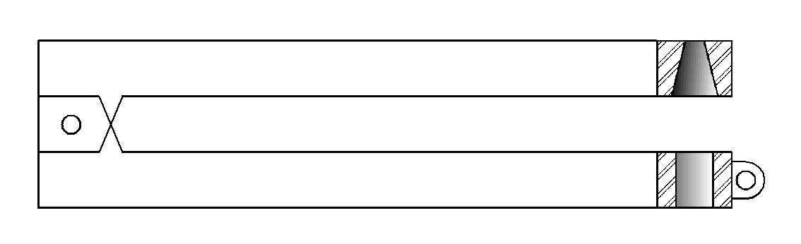

Bart, to make swaged tube ends you have the right concept, just add "heat", "Graphite lube" and "Big hammer"
The attached sketch shows the two major components, a die made from 2 inch round stock, and a tube holder which has a split and pinch bolt to firmly clamp the straight tube section. Clamp the tube in place, heat the end to red heat, bring down the die and smack it with a blow from the hammer. The long arms hold proper alignment, and are necessary. I tried using hydraulic press, but quick forming is necessary. A big vise can be used instead of the pinch bolt, but a split round tube holder is necessary. If the tube is short, just a base support may work, but I had to make the tube holder for tubes over 12 inches long (7/8 OD x 0.065 wall mild steel tubes), otherwise they would sometimes buckle or damage the unformed end.
I was also playing with doing this on the lathe, with something like a pipe /tube cutter, fitted with a big blunt roller rather than a sharp tube cutter, work here pending further experiments, that day job keeps getting in the way.
Actually, I like Mike's concept better, as evidenced by the boiler in my boat.
- tube swage die.jpg (25.24 KiB) Viewed 11320 times
