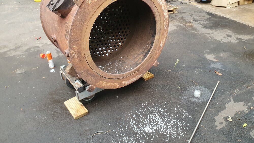

I came here following a google search on the topic, after a suggestion elsewhere (Malc Ducket, via the SBA Whatapp Group) to use TSP to clean a boiler shell prior to inspection during re-tubing.
My conclusion is that while TSP in small amounts might well be a reasonable alternative or addition to commercial boiler treatments for rust prevention (unconfirmed) and or in stronger quantities, for treatment of surface rust (a bit like a phosphate wash conversion coating), it probably doesn't do a huge amount for heavy oil deposits on it own.
For that you are likely better off giving it a good rolling boil with Washing Soda crystals (Sodium carbonate, Soda Ash) as per the post above, which is something I have done in the past with our boiler. Remove the whistle and vent the boiler through that, give it a good rolling boil at normal water level. And then we actually then pumped the water level up at the end and intentionally over topped it, which sent a huge amount of oily scum up our onto the roof! Very impressive, although next time I would do more to capture it, rubber hose over to a large bucket on the ground, away from the paintwork! We then damped the fire out, blow it all down out of the bottom of the boat, refilled, drained, refilled and steamed as normal.
However in my case the rolling boil option is now out of the running because I have removed it from the boat and taken out all the tubes! Maybe I should have done the above wash cycle before that, but from where we now are. At which point, various advice including my gut feeling and a chat with the lead chemist at work, has lead me to the suggestion of using domestic oven cleaner, while wearing eye protection. After all it is formulated for removing baked-on grease from steel, it is very alkaline which is basically all you are after, and has suitable thickening agents for spraying/soaking/rinsing surfaces you can't soak. Plus it's easy to get hold of at the supermarket!
I have also procured an extra long thin lance for my pressure washer (a 1.5m 1/4" BSP stainless steel tube basically) so once it has soaked in the oven cleaner spray I can then jet wash it to mechanically remove the loosened material, and try and wash it all out of the wash out plugs. Might hook the hose up to the hot tap too and feed it warm water for good measure.
This is all theory to date, but I shall post back in a few weeks!

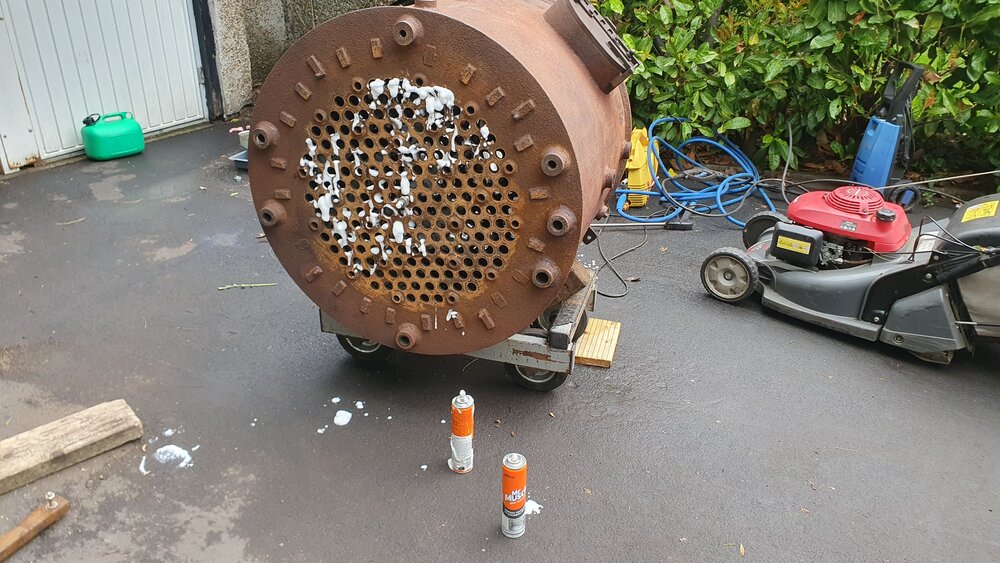

Well, in for a penny in for a pound!Dhutch wrote: Tue May 27, 2025 10:17 amAt which point, various advice including my gut feeling and a chat with the lead chemist at work, has lead me to the suggestion of using domestic oven cleaner, while wearing eye protection. After all it is formulated for removing baked-on grease from steel, it is very alkaline which is basically all you are after, and has suitable thickening agents for spraying/soaking/rinsing surfaces you can't soak. Plus it's easy to get hold of at the supermarket!
The overall outcome wasnt great to be honest.
Firstly its unsurprisingly hard to get the stuff where you want it. The fitting on the aerosol nozzle wasn't the common type, which ruled out swapping it for one a straw to get a jet rather than a mist, so I ended up just opening it out with a small (1mm I think) drill bit and doing what I could to get it on the tubes, which involved looking through one hole, spraying through another, and regularly clearing foam from the nozzle area and swapping to another hole in the tube plate having filled that one with foam. All while in disposable nitrile gloves and workshop goggles, trying really had to not get it on my skin on on my eyes. I also had a bottle of the 'tip into a bag and soak the trays' gel which I mixed with 50% water, stuck in a pump up hand sprayer, and again sprayed half blindly into the drum at the tubes, this time mainly aiming for the undersides of the tubes which I couldnt get at all with the aerosol. Photos below of the coverage.....
....left all of that for half an hour and hour, and jet washed it all off with my 1500mm extra long pressure washer lance, For about an hour, doing my very best to clean all the surfaces of the 19 stay tubes, as well as the foundation ring, and washing out all the lumps. Having hoovered out 90% of the loose stuff when it was dry.
Then I left it all to dry, and reviewed what I was left it. Well it was a bit better... ...but a long way from clean tidy nice to inspect metal.
So I then made a scraper I could get through a tube hole and run along a tube, and with that, and a good torch, almost as much by feel as visual, myself and the boiler inspector were able to gain enough confidence that the wastage after 30 years service was not significant and we could continue with the retubing.
