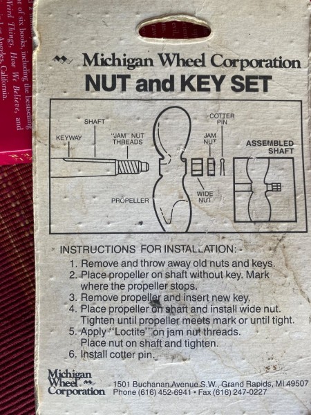

Advice from Michigan Wheel on jam nuts:

Nice to have a fancy conical jam nut...
How's the engine build coming along?
Posts: 1925
Re: Tiny Power M Twin Build
Conical? I don't get it. But that's nothing new.
