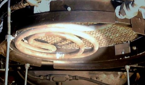

Post by swedtug »
Here you can see the superheater tubes under the boiler, if you look carefully you can see the small superheater tubes to the atomising burner in the Middle.
