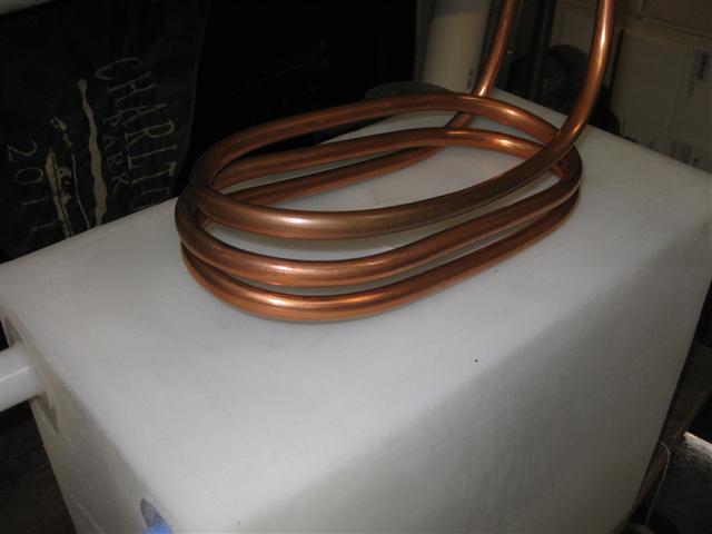

Well, for a few years I've been trying to figure out how to get hot water on the tugboat without parboiling myself. I was originally going to mount a small tank under the sink and run a steam line through it. The tug has two 10 gallon plastic water tanks, one is for fresh water, the other was for the sink drain or gray water, and it had a pump to empty it. I found out that the latter wasn't needed. So I yanked the old tank and bought a new one to replace it. The sink drain is now piped in to the same through hull (I know this is all sounding like a three stooges episode) as the ejector with an isolation valve in the drain below the sink so I don't blow bilge water back through the sink drain when using the ejector. So I had the bright idea - make the new tank for hot water - install a steam coil in that. So that is what I did. However, I had to add another on demand pump for the hot water as it is a totally different system than the cold.
The coil is 1/2" and I'm running 1/4" copper over to it, the idea here is that the half inch copper will have more surface area to heat the water. Then the exhaust line for this will be 1/4" and tie in to the exhaust for the southworth steam pump. I think I will be able to control the temperature by feeling the line coming out, once it gets warm that means the water is warm as well and turn the steam off. The tank will be insulated so it should keep it warm for a while. Will install a thermometer in it as well just to be on the safe side.
Will report back how it works as I'm going to give it a try soon.

A rather large Windermere kettle!
Re: Steam water heater
Yes, exactly
I have this terrible vision of the heater going unsupervised due to navigational distraction and melting down. How much heat is that plastic rated for? UHMW?
I share the same vision
I'm not sure what kind of plastic it is, looks to be the same kind milk jugs are made from. I have no idea on the temperature rating, but if it got that hot I'd rather it rupture and dump in to the bilge as it would burn someone badly. The idea here is to simply warm the water for showering, shaving, washing dishes etc.
I'll just have to pay close attention to it and monitor the temperature rise. I have a feeling it's going to work pretty well.

My mind is running along the lines of a steam valve operated by bi-metal strip, or similar, to control the temp.
Mike,
Yeah I thought about that and I'll bet there is some existing control that would work.
I found a few here, at 600 to a 1100 dollars it's a little out of the scope of project funding
http://www.mcmaster.com/#temperature-co ... es/=xun6sp
How about making up something using the wax insert from a car thermostat? Generally the temp range is a bit high, but perhaps some form of adjustment might be possible.
Mike,
That's possible. Mount the sensing side in the tank and then mount a stop valve to the outside. I may experiment with that when I get time.
Looks like if the expansion unit was removed from one of these it could be made in to a cheap control unit. Mount it in the top of the tank to prevent leakage. Then extend it to the bottom of the tank. Have a rod that controls a modified straight push needle valve. I think a low temperature (160°F) thermostat with springs removed or lower tension springs could be calibrated to about 140°F pretty easily.
