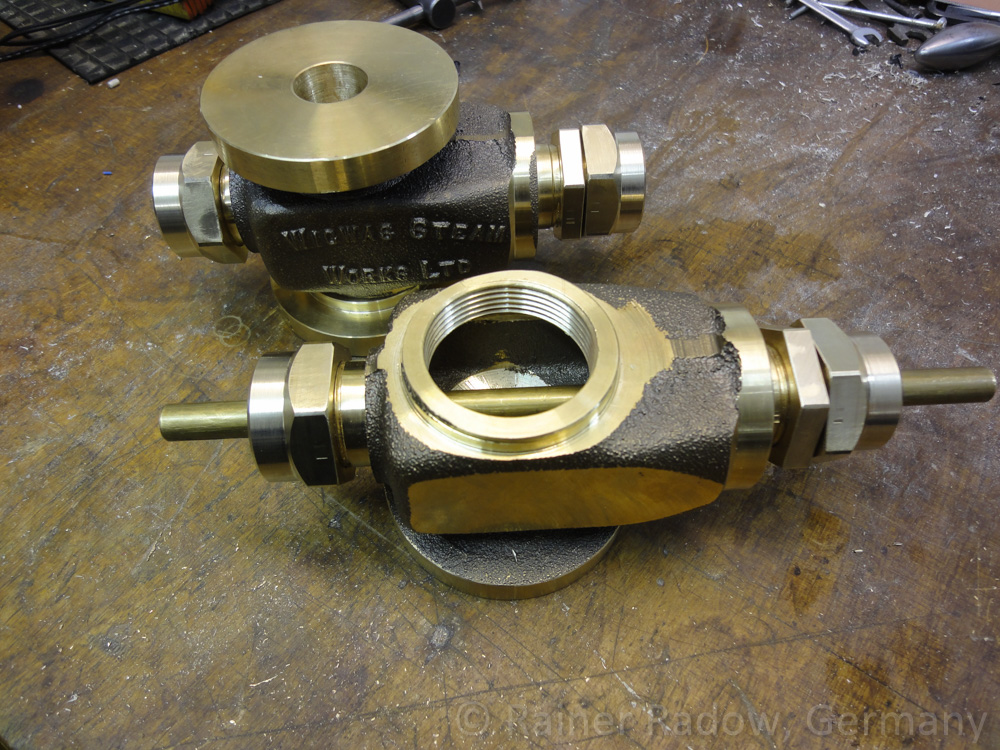

There has been some chatter about the "V" extension of the main port opening. The shape and depth shown in the builder's notes has worked well for 2 seasons in 2 boats. It allows a progressive opening and good control for low RPM operation. I do not recommend deepening the groove or cutting it all the way through.

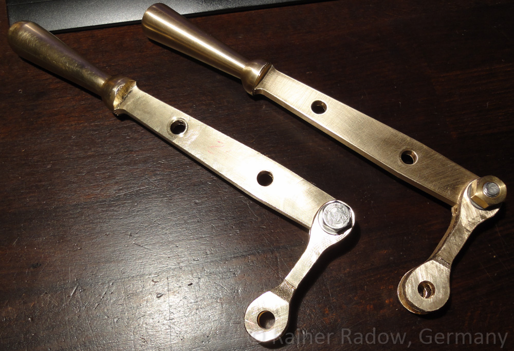

I did some more machining. This has to be ready next weekend because I have to bring it as a present to the USA...
I did the machining of the lever a little different than stated in the instructions.
All this was done by manual turning, file, sand paper... - have "to CNC" this lathe also some times...
Technical ready - need some more surface finish

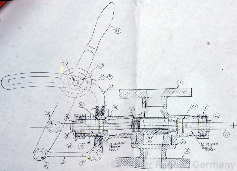

Now I have to make the sliding part #3 guided by #4. Please have a look at the original drawing. For me this is not a good design to eliminate alignment problems of the valve rod #11 and the sliding surface of #2. To give some flexibility here you have to make a loose fit between #3 and #4 - but what fore do we have to make this massive part #4 if we have a loose fit here? Why not making it without the #4 just guided with a nut on #11 rod - like a D-valve.
Please tell me your thoughts!

Todays status - this quadrant is a lousy part - week and difficult to clamp. Lots of possible/necessary alignements.

Looks great Ranier! It appears you left the quadrant as designed?

It looks like you redesigned the actuation rod (part 11) to use a cotter instead of a thread to retain the throttle yoke (part 4). Tell us how assembly goes as it looks like it might be a bit difficult to get access during assembly. It certainly saves some work on the actuation rod.

Re: US Navy Type-K VALVE
Yes, I did the quadrant as it was in the original design.
Yes, I changed the actuation rod #11 design. I like to use ready grind stainless rods for something like that. I am not able to machine a surface like that. Without the thread I don't have to do so. It was easy to pin it from the top and bend over the pin ends from the bottom.
If you drill the pin hole after you machined all the other parts you don't need the possibility which you get with a thread to change the open/close position.
