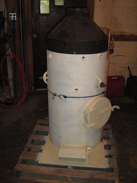

As far as tiny power/rappahannock boiler prices, Ronnie is building me an ASME code S stamped 5 hp, VFT approx 40 ft2 with smokehood, grates, firedoor, draft door, and mounting plate similar to one in attached photo (a 10 hp model) for $6500.
- IMG_0811.jpg (44.7 KiB) Viewed 17137 times
Regards,
Bret
