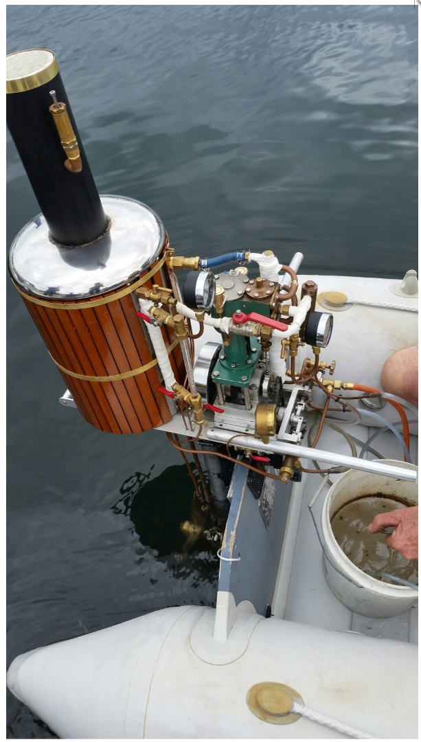

I squirreled this picture away some time in the past….not sure of it’s origin…..but a steam outboard is a fun idea.
I have a couple of old British Seagull outboards who might offer up the ‘leg’ and prop. Some Stuart Turner Castings might work? But the boiler is beyond my experience. Realising that it needs certification etc so not likely a job for me…..does anyone have any wisdom on what is in the picture?

Thoughts welcome! Particularly on what that boiler is. Should I go everything conventional and inboard. Likely displacement issues? Or consider outboard?

For the issues involved w/ traversing the legal obstacles w/ boilers in GB, you'll want to talk to someone there locally. Those of us in the USA have a patchwork of state-specific regulations; the (national) Coast Guard regulations requiring ASME Code boilers, licensed steam engineers, etc. only apply for boats over about 40' LOA.
One can spend an amazing amount of time and money on a steamboat - or one can build one pretty cheaply w/ a bit of luck and of course bodging.
A steam outboard involves some significant engineering challenges in terms of space and weight. For an initial effort, I'd suggest an inboard. An inboard boiler with an outboard steam engine is also quite workable; there's one operating locally that uses a canoe. There are lots of boats to ogle in the SBA Steamboat Registery...

Regarding those Seagull outboards, remember that traditional steam engines are best off spinning at lower RPMs than 2-stroke gas engines; from what I remember those Seagull engines spun at 4000 rpm or so and used a reduction gear in the lower unit to match engine RPM with the prop. Step up drives are possible, but there's always a power loss.

I concur with Bart on all aspects of this often encountered issue of which route to a steam launch. I would add that installing a shaft log is a minor project compared to dealing with the weight of a boiler hanging off of the back and swinging back and forth when encountering boat wakes.
