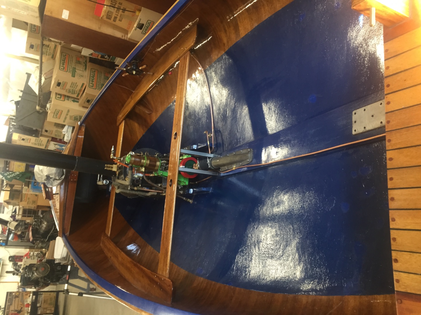

The bearers in my wood hull are bolted from the bottom, with epoxy sealant (I think...) between the hull and bearers. Then painted to match the hull inside bottom.
Because I was not the person who installed them, I guess (during top drilling and threading) that the bearers probably are Oak.
Sorry about the rotated picture...

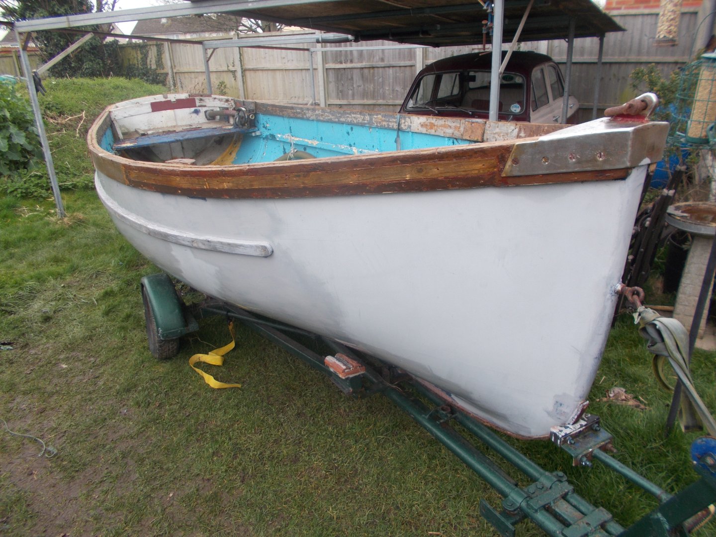

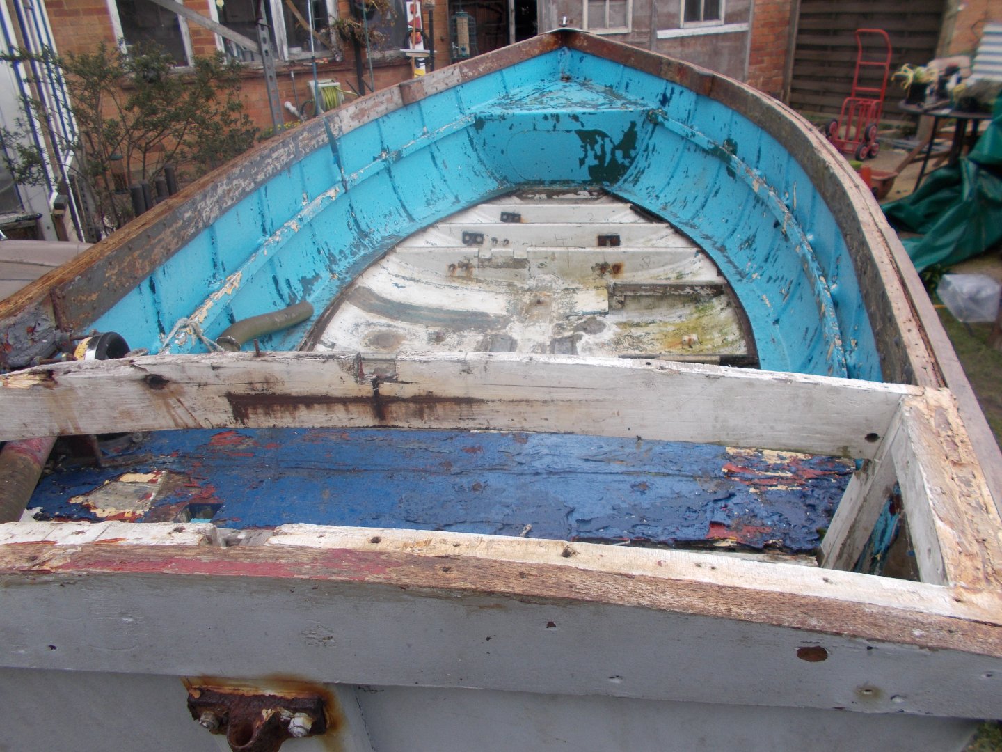

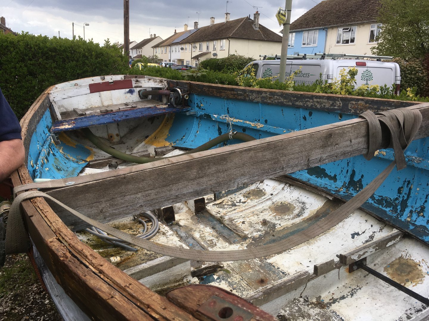

This is the hull I'm working with - she's approx 16' long. Photos are not ideal, they were taken from the sale listing.
Not sure of the state of the bearers/floor supports that are presently there so need to have a good dig about - if there is any doubt they will all be replaced. Do should I have a pair of longitudinal bearers along the length of the hull or just have them where I need to attach the boiler/engine, and then rely on the floor supports for extra strength?
I have no idea of the quantity of resin/glass I'm going to require either, any suggestions on how to estimate that?
Re: Bearer Material Selection
Posted: Tue Sep 07, 2021 12:48 am
by barts
Since it's difficult to estimate exactly how weights are going to balance out, I'd use long enough bearers to allow you to adjust boiler and engine position to get the right balance - at least +/- 30 cm. The boat is small enough that your position will affect the trim significantly as well. You'll need floors anyway, so having those will make it sturdier.
