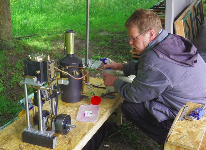

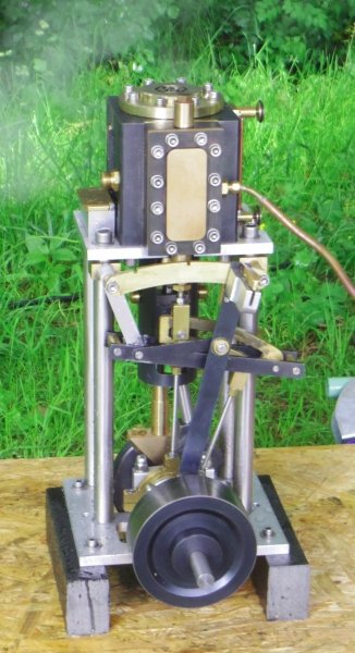

Hello,
some times ago i have bought a HASBROUK#10 inspired column-style-single-steamengine. It was successful run by the builder with compressed air. It has a boring of 59,5 mm and a stroke of 74 mm.
It was tested first time with steam and runs but there were a lot of questions.
https://youtu.be/nDA1d1FEuCY
Regards Dietrich

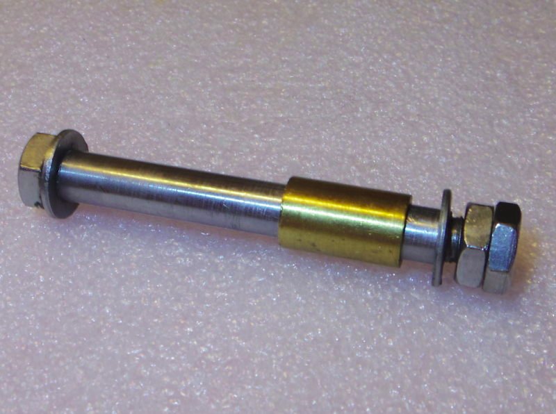

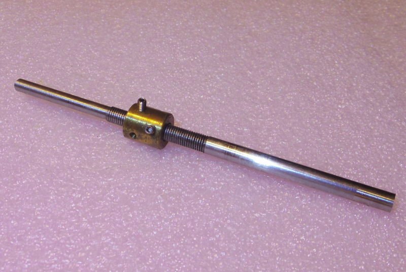

to check the dimensions and the accordance with the HASBROUK#10-drawings i have dismantled the engine. I have found some solutions i have never seen before.
The slide rod
The crosshead bolt
It could move in the crosshead and the upper end of connecting rod.

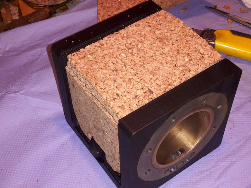

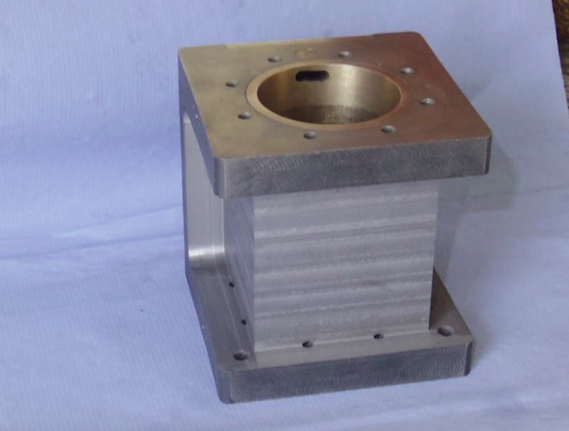

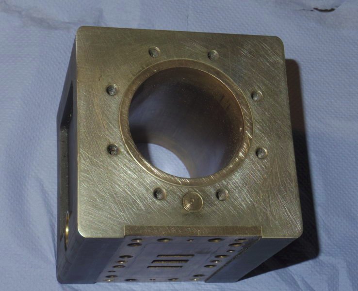

Back to the cylinder of my engine. It is machined from a very massive cast iron block with a rifle and a plate of gun metal. Both are glued, the plate also screwed in place.
I have removed a lot of material and replaced it with insulation of kork. It was covered with a layer of pear.
