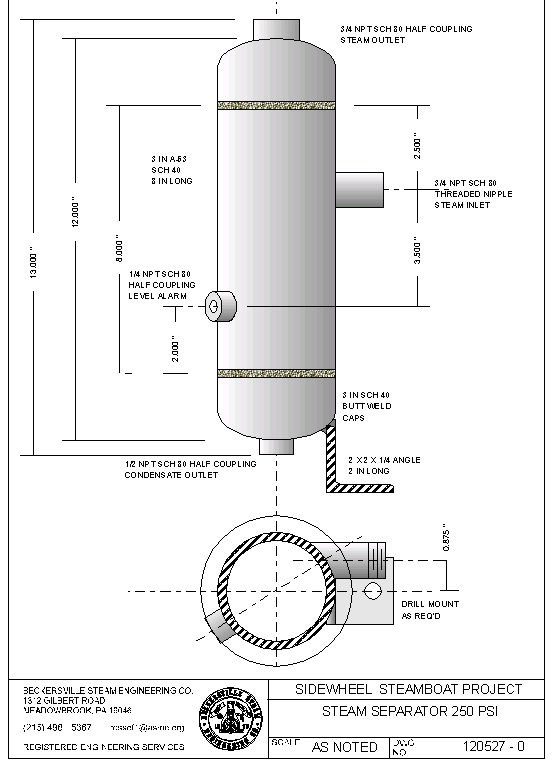

Large plant practice dictates a steam/water inlet, tangential to the vertical main vessel, about half way between top and bottom. Vessel steam upflow velocity 3 feet per second (about 1 Meter per second), with minimum 1.5 main vessel diameters above for steam outlet, plus 1.5 vessel diameters below to water level.

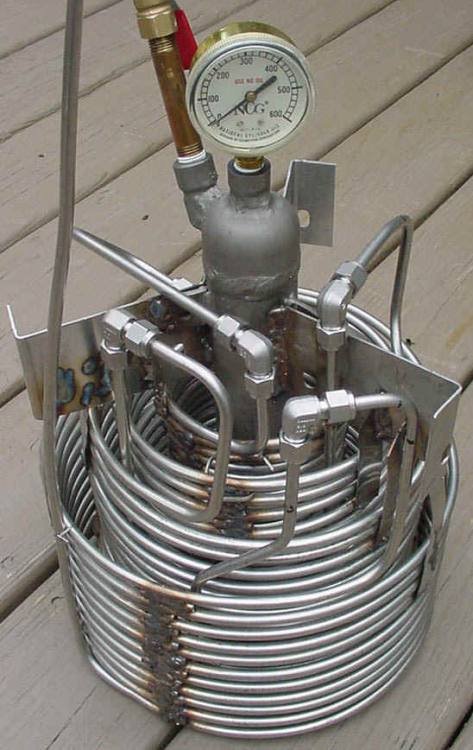

The attached file is a separator tank on my steamer, used only to protect from water carryover if the boiler primes. The bottom outlet leads to a steam trap, which is fitted to discharge any water accumulation.
- MS-SEP.jpg (68.57 KiB) Viewed 6610 times
