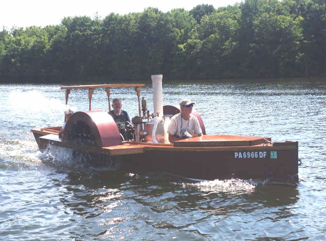

Posting pictures is easy and direct on this forum. Below the reply windowyou can post a file, for me usually a JPG or JPEG file. The only issue is file size, I believe 100k is the limit, but the many photos I have posted here all look OK with that file size limitation. If your picture is too big, most photo software allows you to resize the photo, and save it with lower resolution.
Note that a small steamer would not need reverse, if you are comfortable with an ordinary paddle for maneuvering while docking, etc.
Also note that my sidewheeler has been operating for years with only 0.6 horsepower, and it weighs more than a tonne, with an obsolete, and relatively low efficiency propulsion system: paddlewheels. So in a small steamer, fractional horsepower may be completely satisfactory.

I agree, when I go out on the Delaware river I must consult the tide tables for a reasonable launch time, or travel takes too long. As a matter of fact I plan to push my steam plant up to over 1 horsepower this summer, adding an exhaust steam feedwater heater, and an economizer. That should allow extra steam generation, enough to get main steam pressure up 25%, which should do fine.
