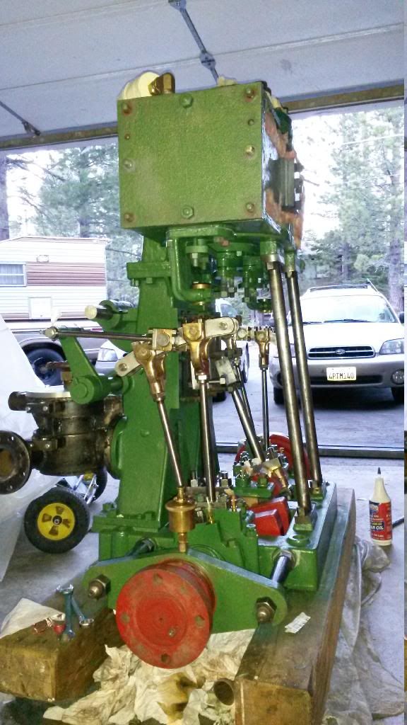

The Doty Compound is slowly coming back together...
My father cut the packing gland portion off of a large gate valve that was junk and we're using it as the gland for the condensate pump. Stem with valve handle is in there at the moment "just because". Obviously the piston and valve rods aren't in there yet as I've still got some things to do with the valves and LP piston.

Re: Next Weekend II
An interesting engine, nice to see “proper” double bar marine links and I particularly like the cast eccentric rod ends. The distance between the eccentric rod ends on the link looks a little short, I would be interested to know the distance (relative to full valve travel) Loco people use about 2 x but all my old marine books state 3 x. Could you also comment on the crosshead pin bearing arrangement? Cannot see from the photos, always interested in different ideas.

Re: Next Weekend II
Jack,
It truly is a "proper" marine engine, what with cast back columns and slanted turned front columns. The aesthetics are probably the #1 reason my father decided to run it in the boat rather than the French "Calparede" compound.
I will have to measure the valve travel and rod end distances on the Doty and the Claparede for you.

We're getting excited. It's hard not to be tempted into just throwing it together. I am taking a couple cast iron plates and bar stock to get blanchard ground tomorrow for new crosshead guides. Some parts are going to have to wait for future refurbishment though.

Thanks Ron!
