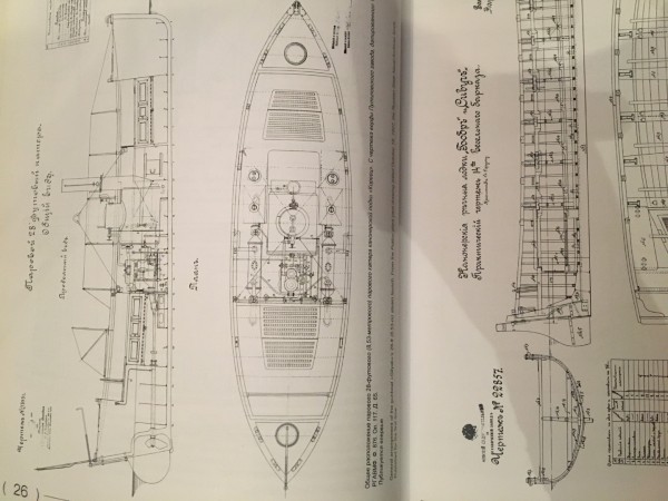

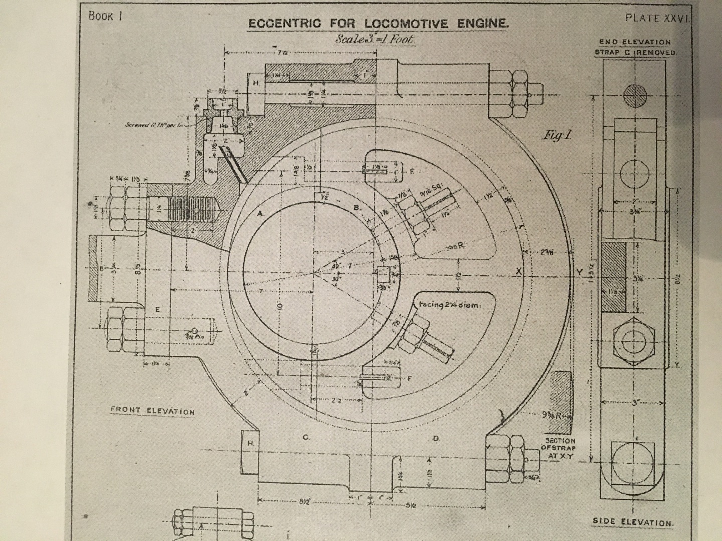

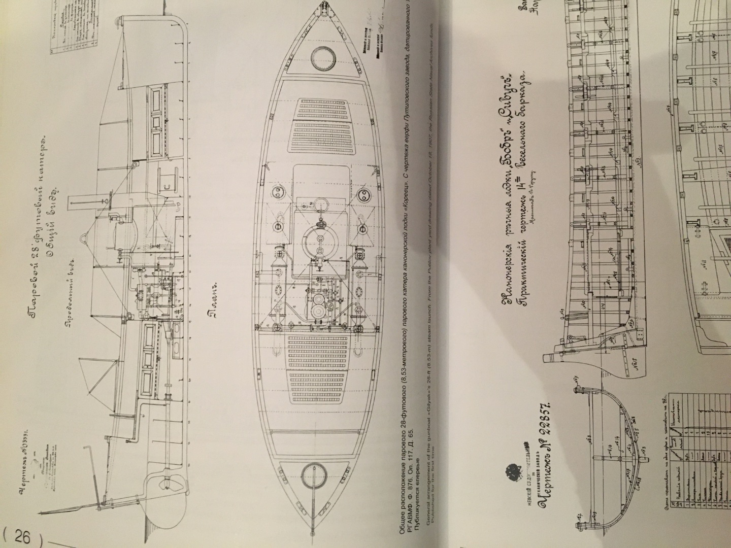

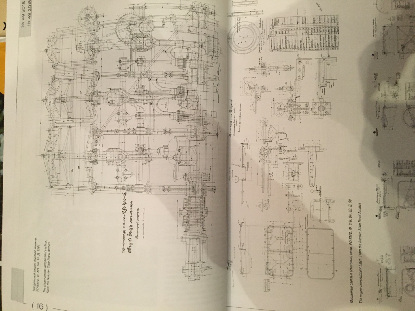

Dear fredrosse! I apologize for accepting the figures you gave for the steam boat project for the opinion of DetroiTug. My poor English and my inattention are to blame for everything. Even 7-8 years ago, information about steam engines and steam boats could only be found in some magazines. I attach photos of such magazines. The magazines contained general information about large torpedoboat steam engines, which weighed several tons. Cylinder diameters from 280 to 800 mm. and more. I could get the necessary and detailed information about small steam boats and engines only on your website quite recently. The boat hull that can be found in my region can be about 8 meters long and at least 2.5 meters wide. Weight up to 4.5 tons. These are lifeboats made of plastic, which are of little use for the installation of a steam boiler and steam engine. My steam engine is very heavy - over 350 kg. The weight of the boiler, which I have not yet made, will be no less. This is problem. But I hope that this summer I will be able to start making a steam boiler. I have not yet decided what kind of design it will be. Best regards Ingvar.

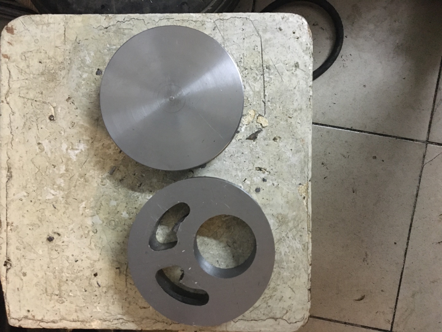

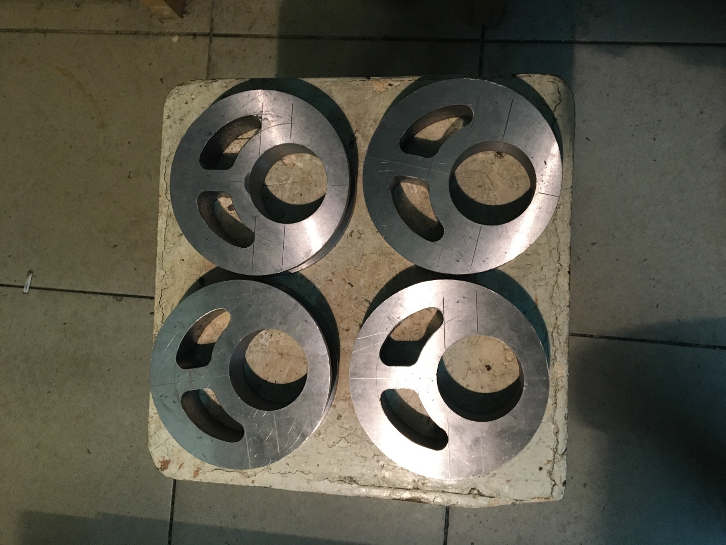

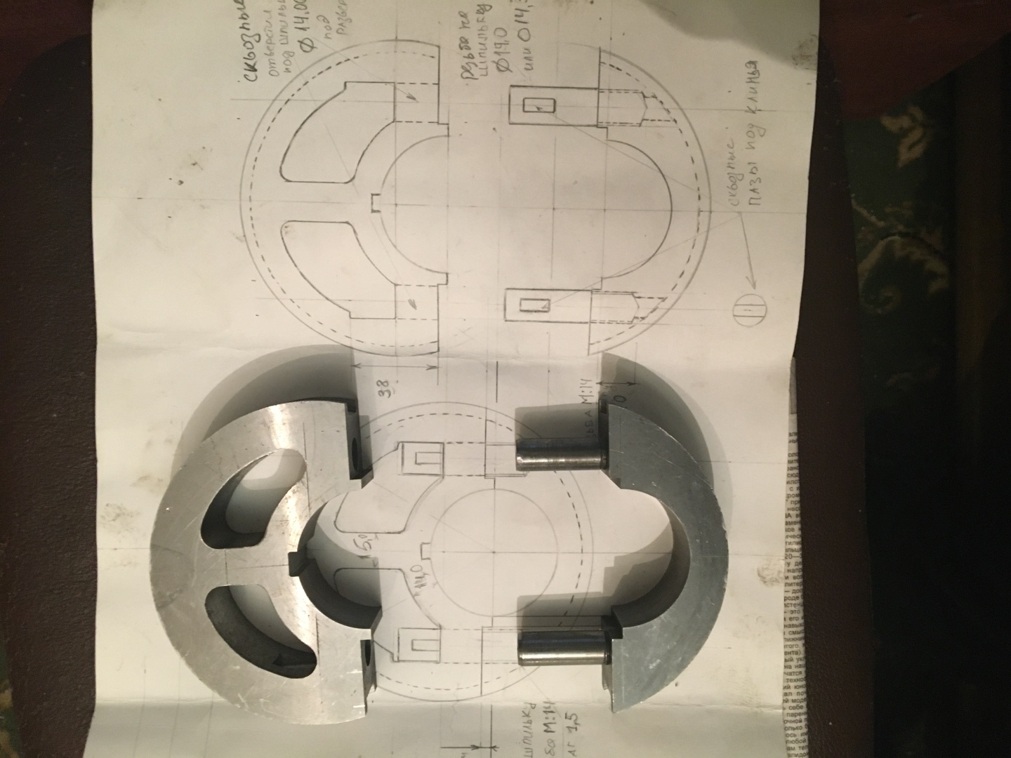

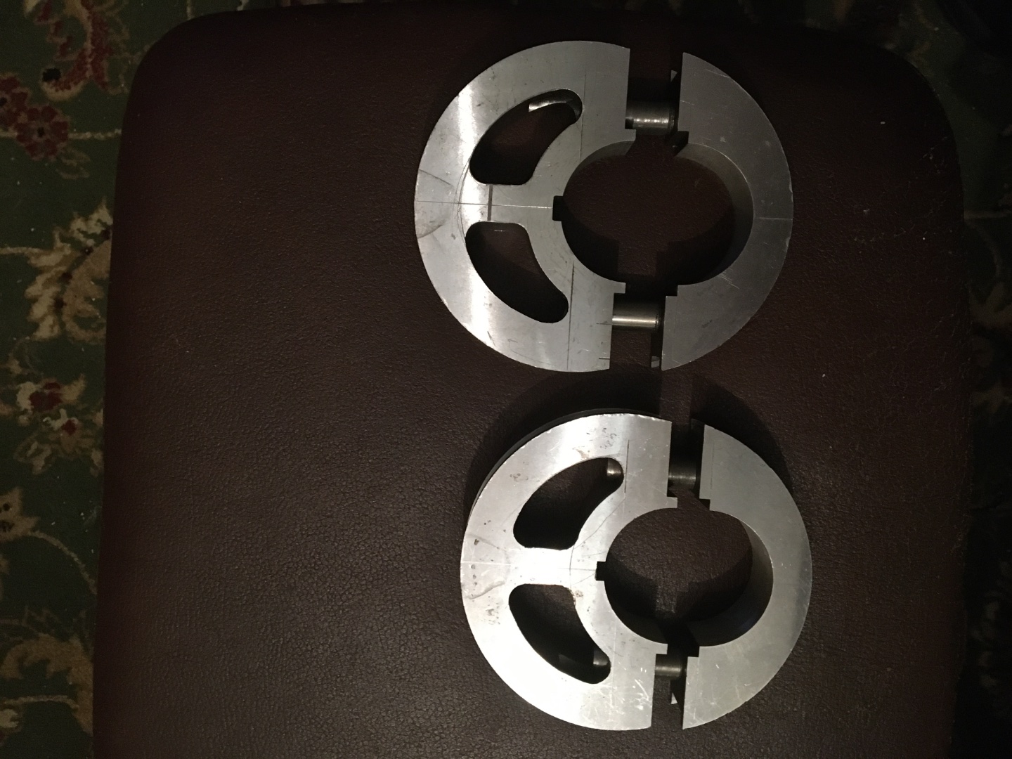

Greetings to all forum participants! Finally, it has warmed up a little in the Caucasus. I began to visit my workshop more often. I managed to cut two eccentrics, two more in line, next week I will finish work on the eccentrics. For a while, I could not post a photo, the Internet did not work well. I congratulate everyone on the coming spring! Ingvar.
Interesting eccentric design. I'm confused as to how the two halves are fastened to one another. I see two studs, but no room for nuts?
Ron
That's very good work with no CNC equipment.

I welcome everyone. Earlier I tried to attach a photo of a drawing of eccentrics. This is an old idea that was used on steam engines in the late 19th century. As soon as I make all the eccentrics, everything will be clear. Nuts are not used in this project. Instead, there are metal wedges. Ingvar.
You are a very clever machinist.
Ron

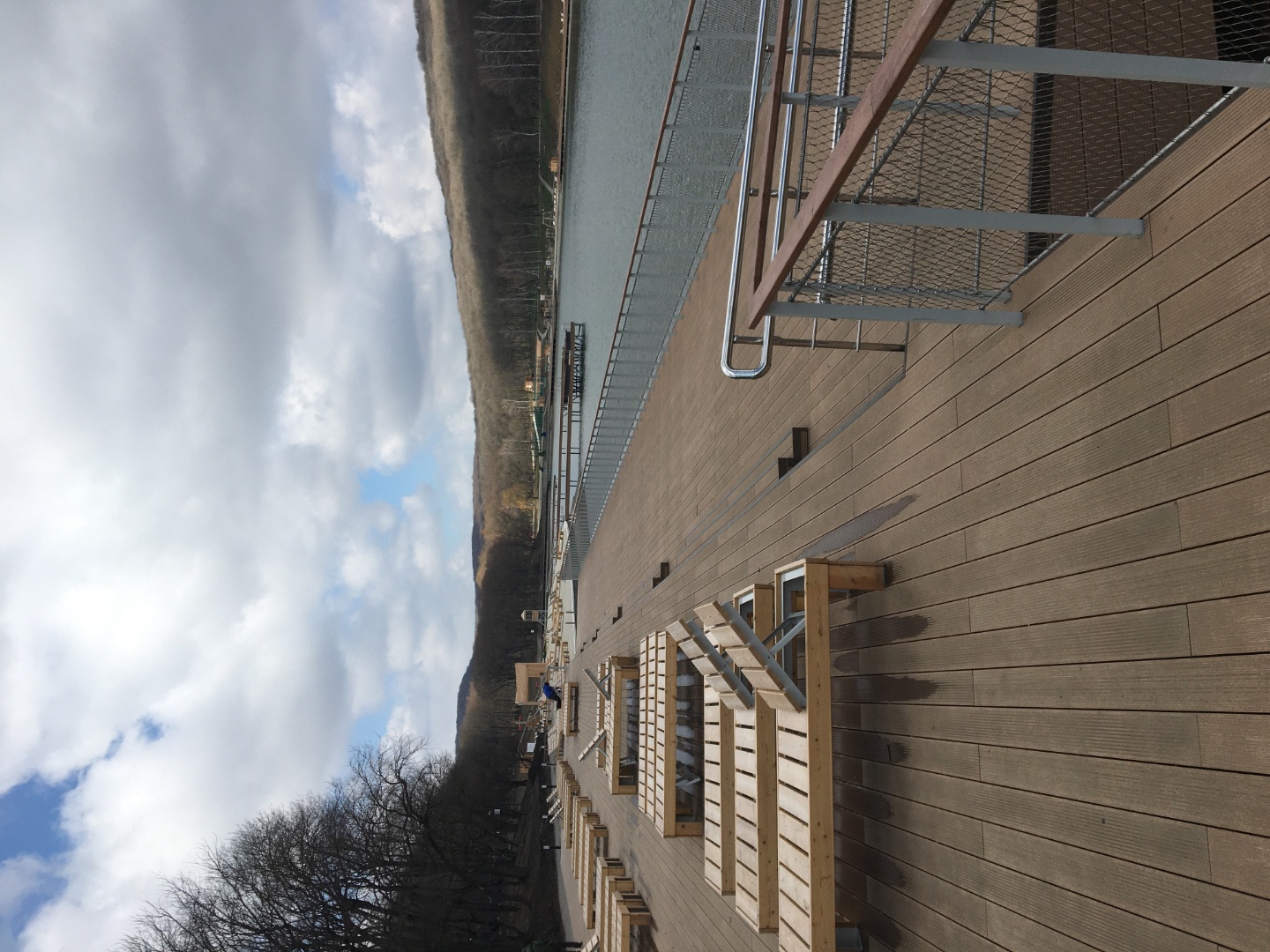

Dear DetriTug! Thank you for the appreciation of my abilities. But I'm not a very good mechanic. This method of manufacturing and attaching eccentrics to the shaft was invented in Europe in the 19th century. I am trying to replicate the design of the steam engine at the time. I am attaching a photo of one of the reservoirs, which is located in one of the major cities of the North Caucasus. This is about 240 km. from where I live. But on this lake you cannot ride on steamers. There are many such cities and lakes in them, but such lakes are not suitable for my travels. We'll have to go to the Volga. Ingvar.

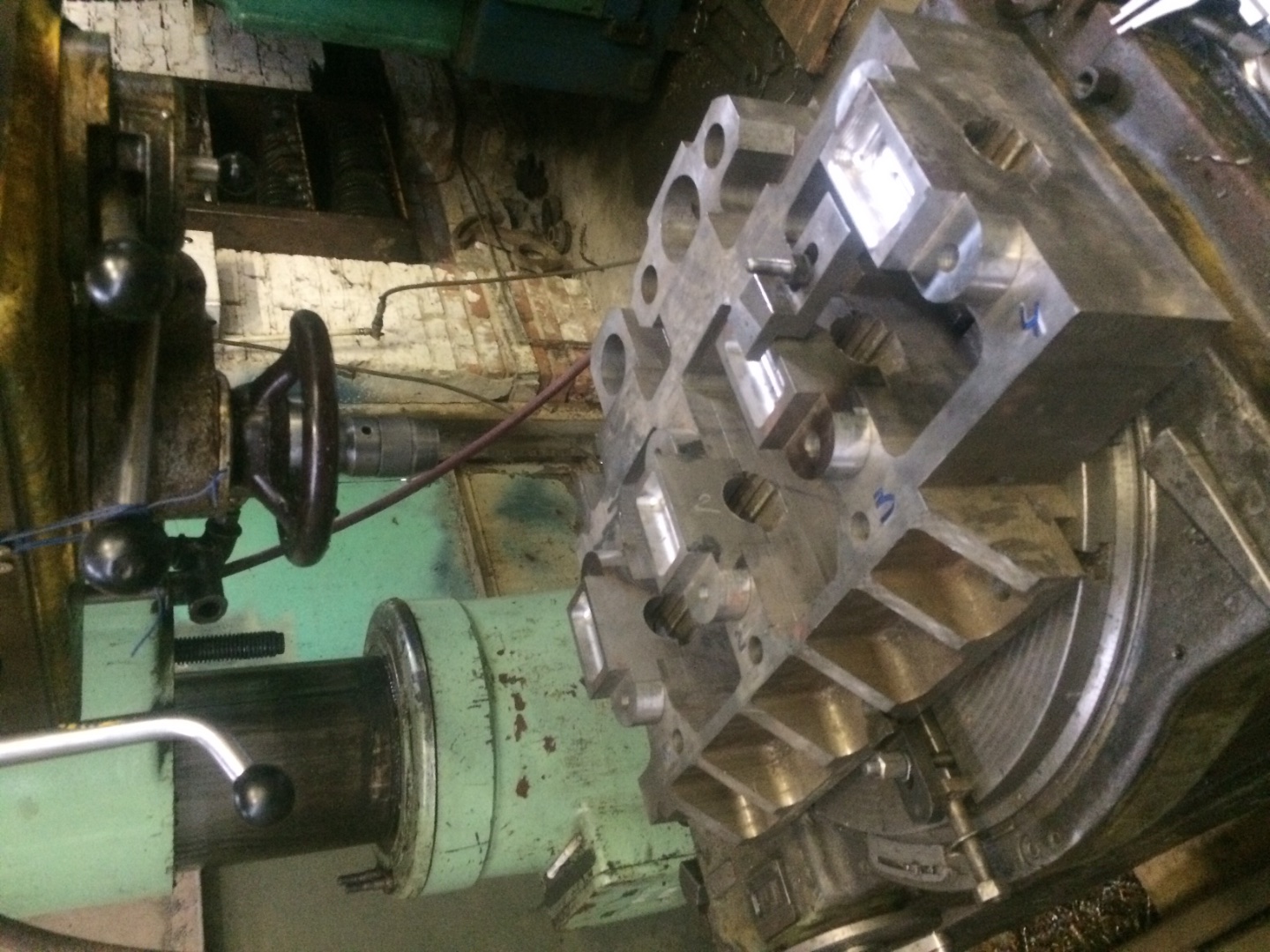

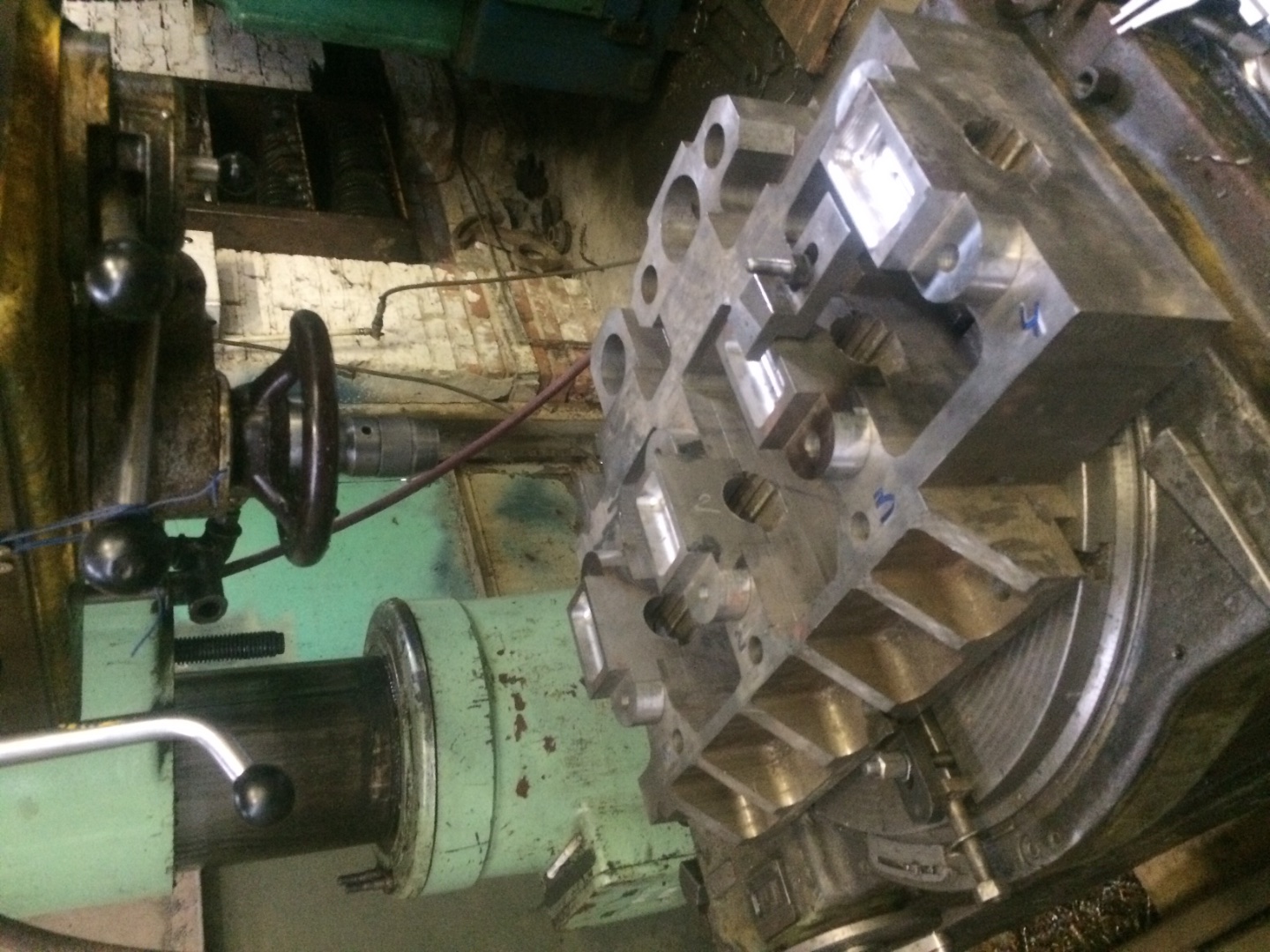

Post by Freezerrr12 »

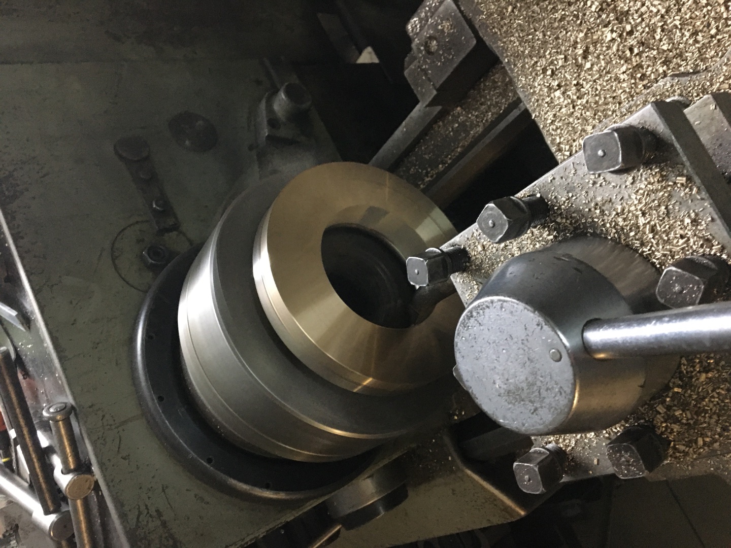

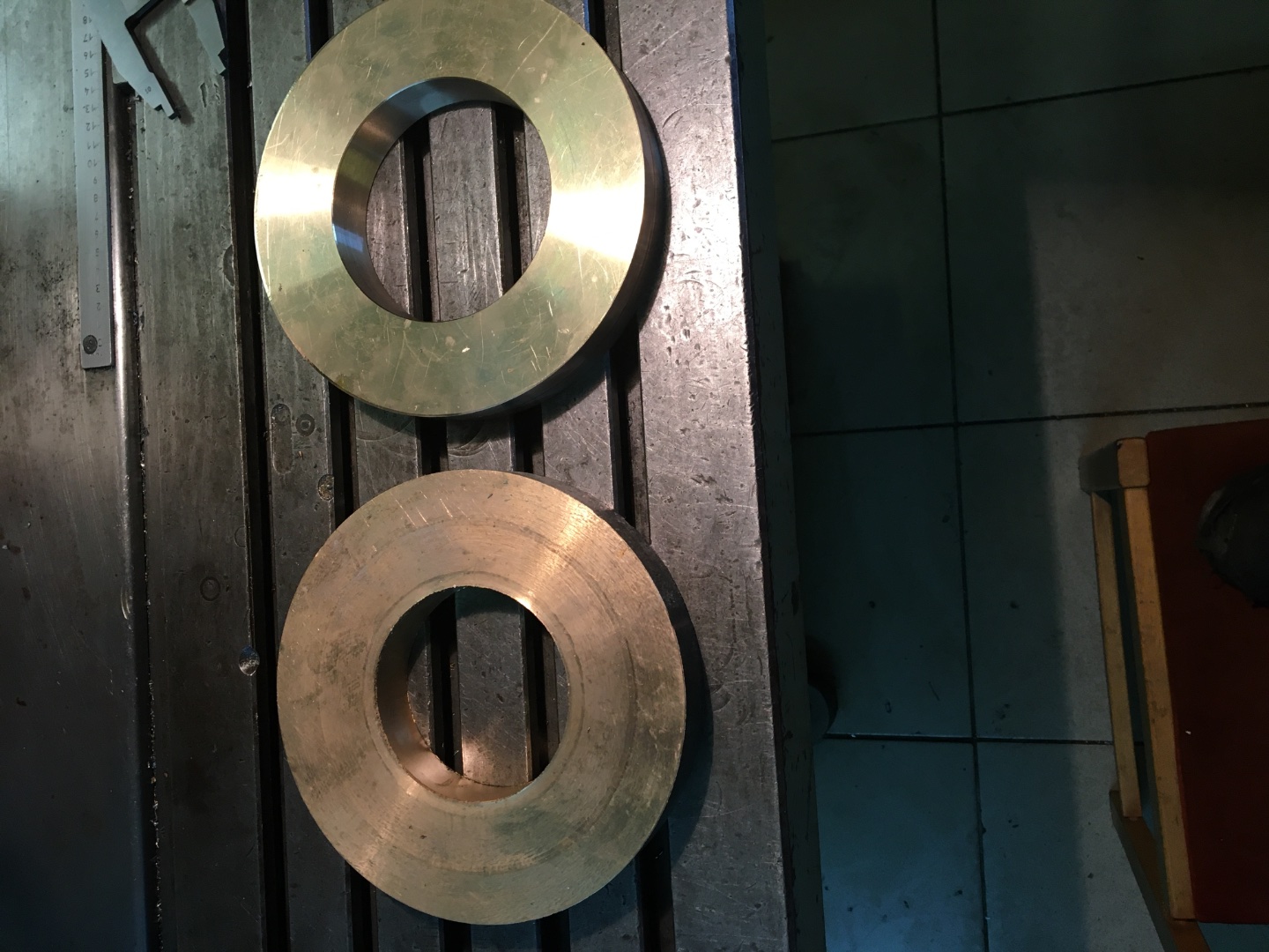

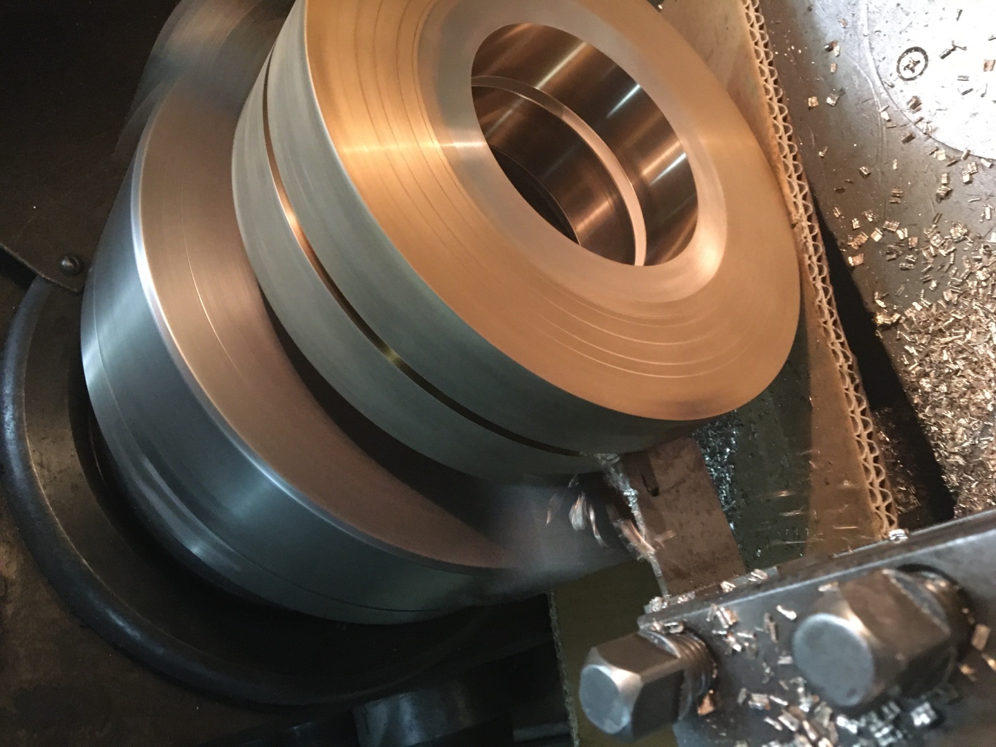

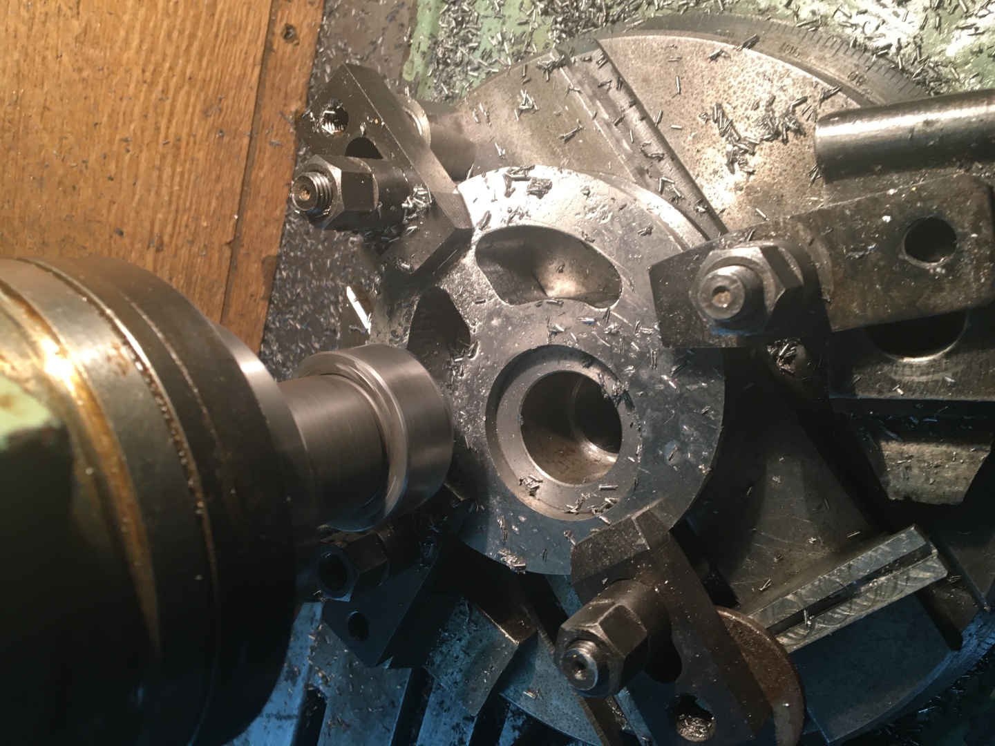

Greetings to the forum participants. I started making clamps for eccentrics. The difficulty was that it was necessary to find the required size bronze blanks with a diameter of about 200 mm. Here's the work that had to be done. I'll try to attach a photo. Ingvar.
