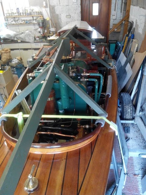

The final 'packing' stage was to add the ridge poles. Of course, these had been put together without all the cabin sides loaded which mean that the diagonal 'legs' should have been a different shape...

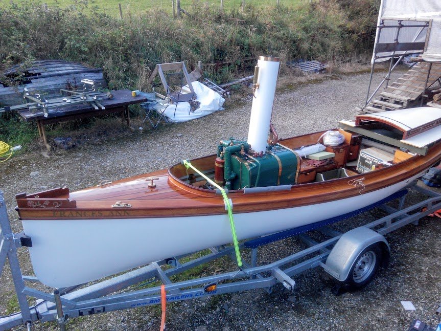

Once all that was done the next job was to get the trailer in balance so that the nose weight was within the allowance for the VW Transporter tow vehicle. The spare wheel was re-fitted as far back as possible but the nose weight was still off the scale. That meant that the trailer had to be jacked up, the axle U bolts undone and the whole caboodle hauled forward. Much sweat managed to get 4" (10cm) of movement and a nose weight of 60kg. That seemed like a point at which to call it a day.

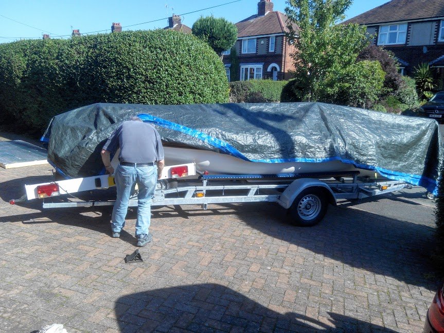

Next day Mike Rometer joined me and things went a whole lot faster. After readjusting the brake actuation bar, we rolled the trailer out of the garage into the sunshine and set about adding the mudguards, pumping up the tyres, etc. The tarpaulin was added in case of rain and eventually tied down. Final checks were made and we then hitched up the VW to check the lights with the rig completely blocking the road. Of course one cluster would not work...

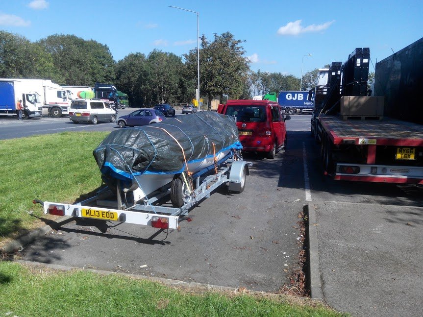

A break for lunch meant having to park rather than just stop and abandon the rig. Since the much signposted caravan parking failed to materialise we joined the truckers. With a decent sized bay available I was duty bound to reverse into it which was achieved eventually.

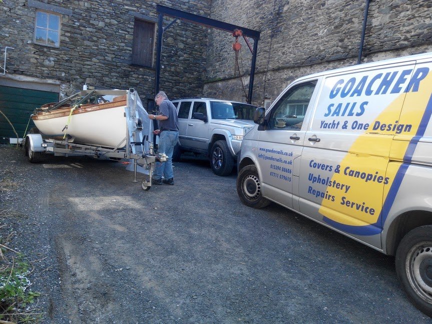

Following a tour of Greg's establishment, or at least the engineering bit, it was time to greet Steve Goacher of Goacher Sails. He had come to measure up the boat for a storage/transit cover. He was a delight to watch. With masking tape, two sided tape, plastic sheeting and a felt tip pen he managed to create a pattern for the cover in what seemed no time at all. He was keen to have us around so that he could ask questions and agree to his suggestions. A craftsman in action.

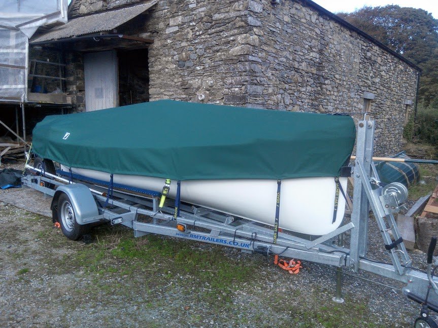

Goacher Sails have now supplied the cover for the boat and it is a first class piece of kit. It is slightly 'tight' just yet but will probably stretch as the winter winds blow.
