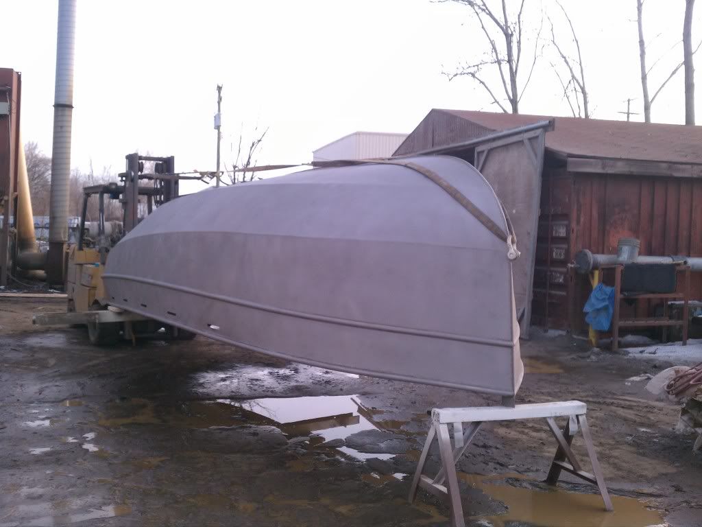

All sandblasted and ready for primer which they said they would apply tonight.
Not too enthused about their rigging methods, oh well, it should be done Thursday, and then I should get it back and will be able to stop worrying about it.

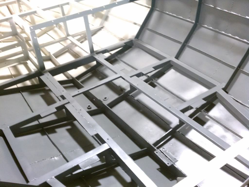

Here is the inside mostly painted.. They aren't done with it yet.
(Pic is upside down)
Lookin' good but I had to stand on my head to look at the picture

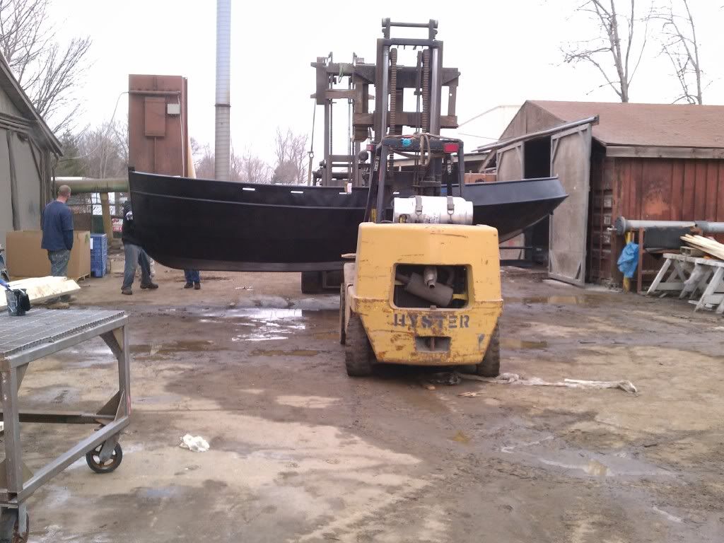

Long day... Went and picked the boat up from the sandblaster/painter. First pic is of them getting it out of their shop and readying it for the trailer.
We got it back and decided the black wasn't flat enough, and for some reason it was blotchy in some areas, probably temperature related, so we repainted the whole exterior. Some of the paint wasn't completely dry when I took this pic.
Then we shot what will be the engine space/cabin with gray.
This is how the inside looks now. Ready to start laying decks and do the rest of the woodwork.
