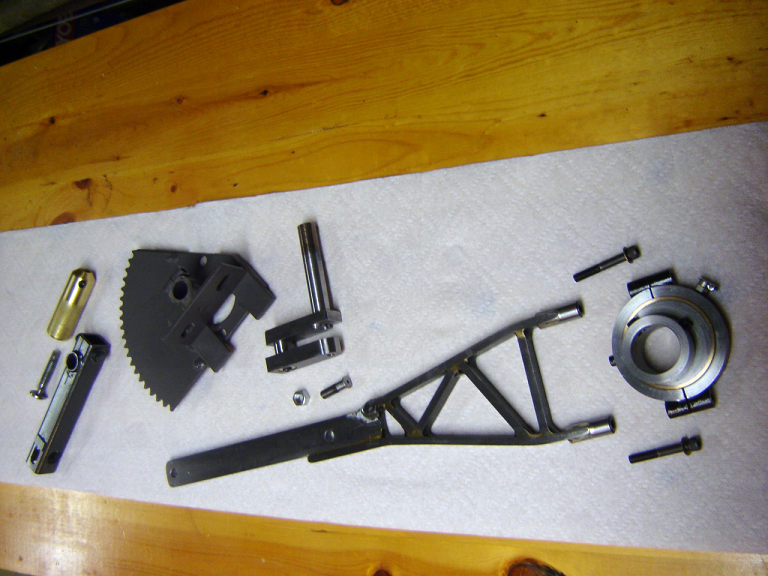

- Valve Gear Parts for Walking Beam Engine
- MARSHALL BREMME PARTS.jpg (82.4 KiB) Viewed 8512 times
