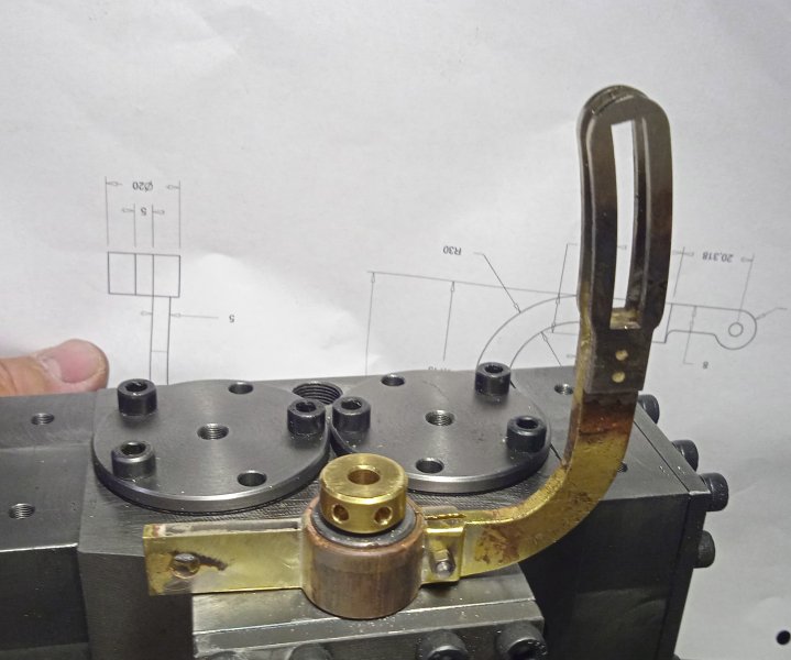

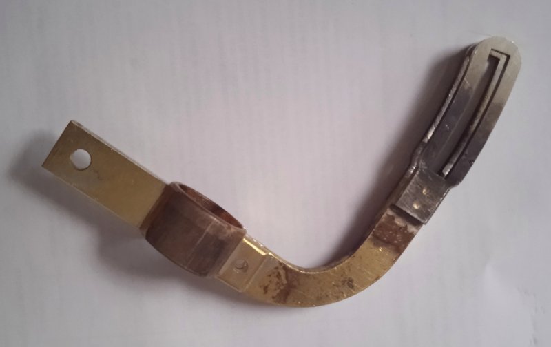

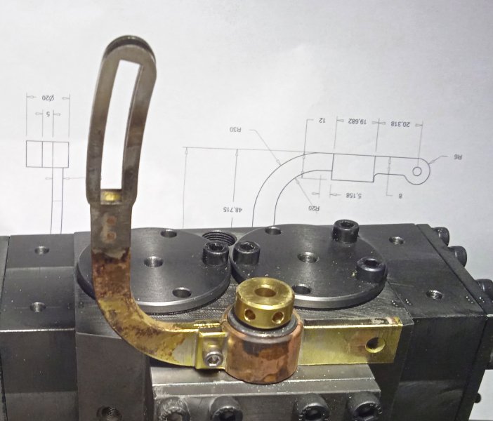

Throttle-Quadrant is soldered
Hello,
the throttle quadrant is built from parts. They are silver soldered. I did it a little differently than what I drew. This makes it easy to align the handle of the regulator lever in any desired direction. There is an M3 bolt to allow the quadrant to be secured in any desired position using a pliers clamp on the lug of the throttle valve body.
The soldered Quadrant
The back side
The back side
The front side
The front side
Next I will sandblast the part, bevel the edges and finish the abutment for the connecting rod to the throttle slide lever.

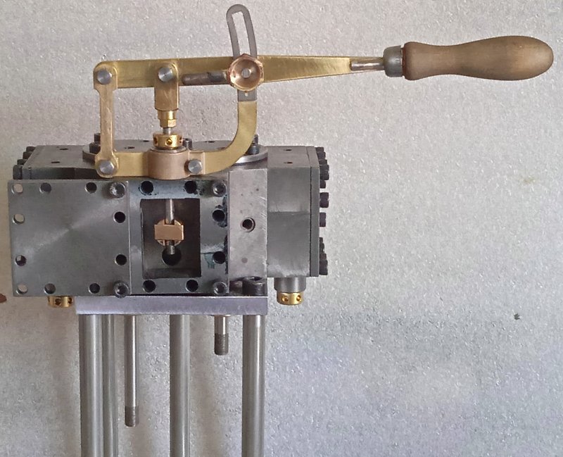

Posts: 279
Re: TWIN 32 x 38 mm - steam engine for small boats or canoes
Hi Wesley,
it is a bit "NAVY K - Style", the pic should answer the question.
Posts: 858
Thank you Dietrich. Than helps a lot!

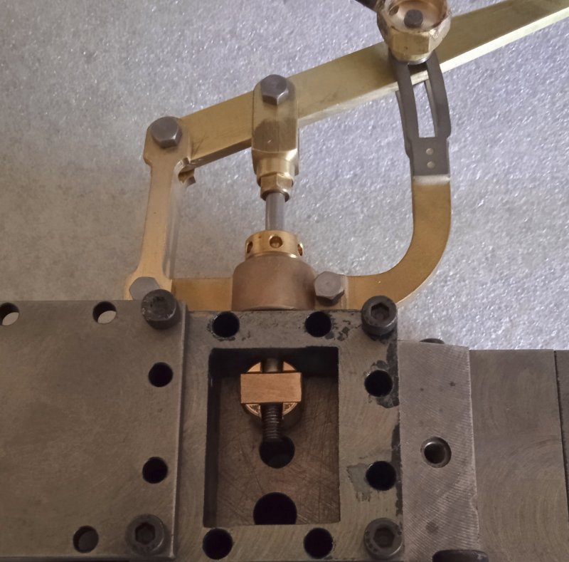

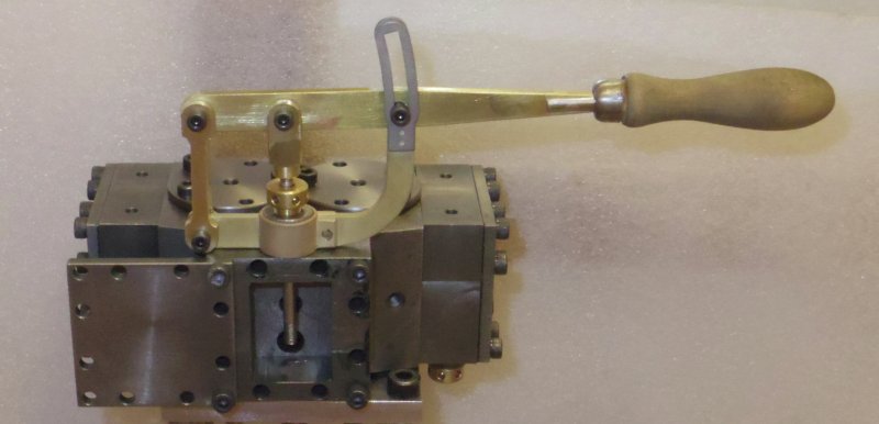

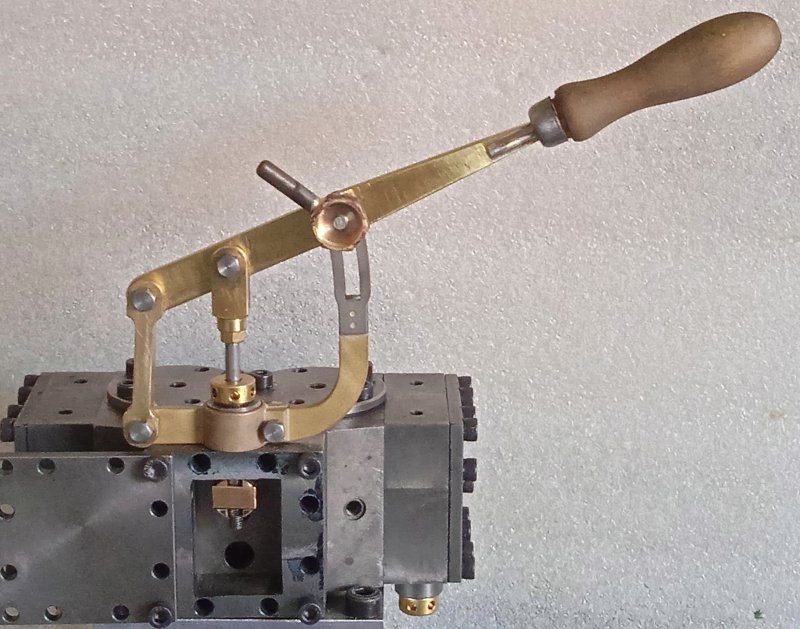

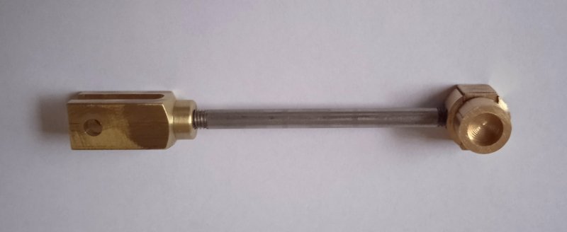

Hello,
the throttle valve linkage is mechanically finished. There are IGLIDUR-bushings in the lever and the bolts in the forks are screwed in (M5 x 0,5 mm) and secured with a lock nut.
It is possible to clamp the lever in in any desired position.
Throttle valve lever in closed position
Throttle valve lever in "full throttle"-position
Throttle valve full opened
All steel bolts and nuts will be blacked when the engine is successfully tested.
