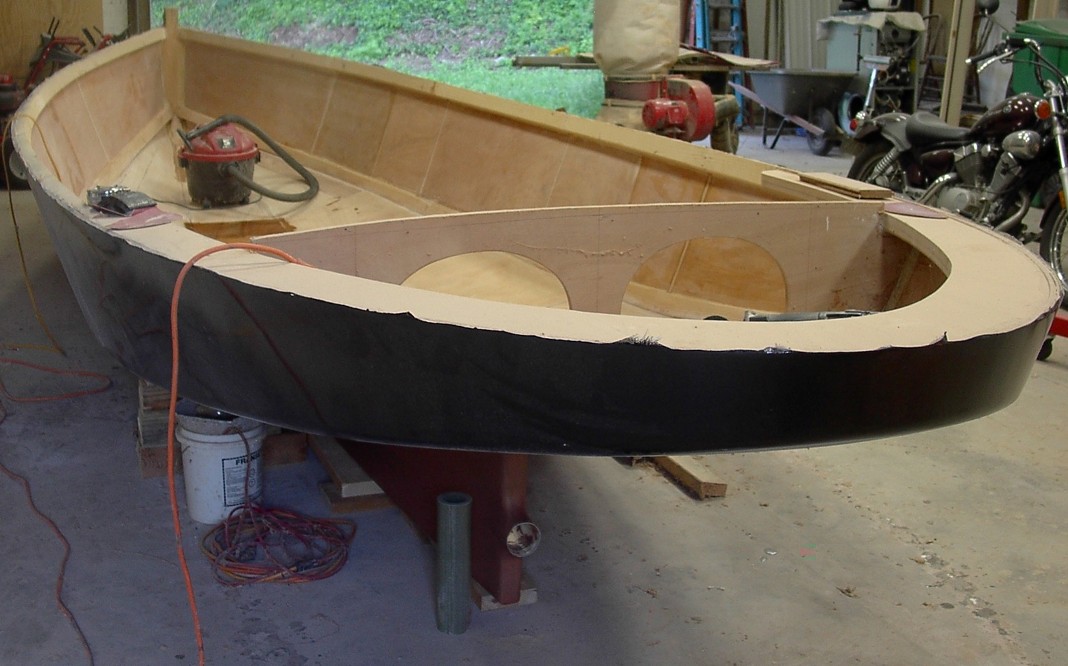

Finishing out the interior ...
IM009464 resize.JPG (153.78 KiB) Viewed 23958 times

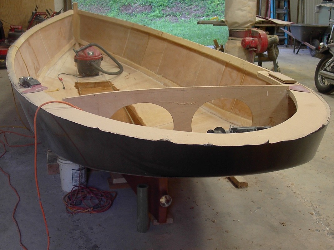

Another perspective ...
IM009465 resize.JPG (192.75 KiB) Viewed 23958 times

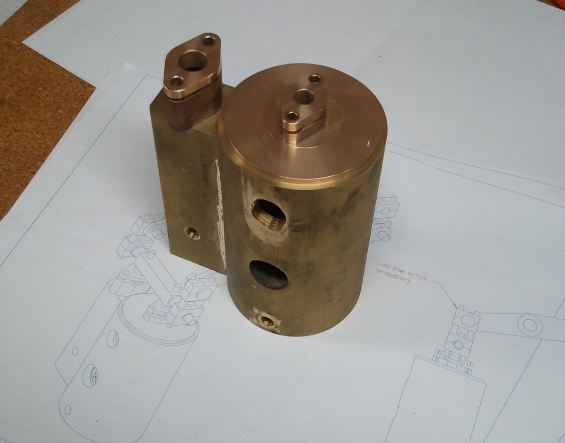

Brother Anderson continues to labor at the engine's air and water pump. Here are the pumps with glands fitted:
2012-08-26 Pumps w Glands Resize.jpg (125.44 KiB) Viewed 23930 times

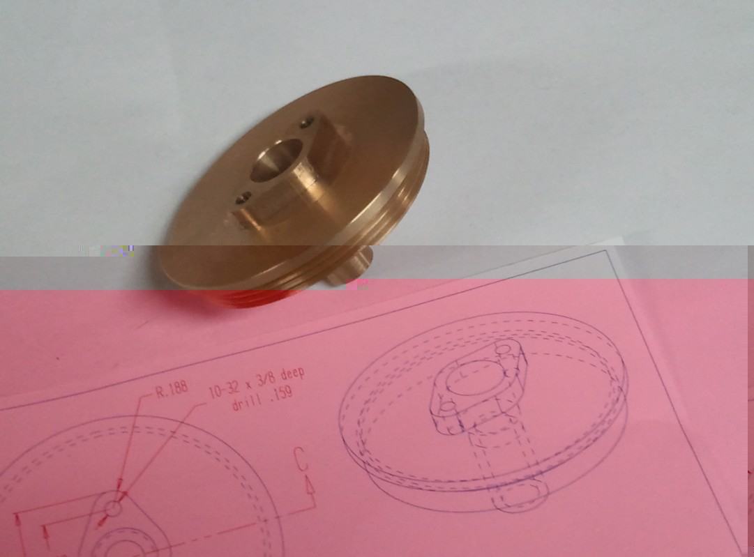

Here's the air pump head with gland and guide fitted:
2012-08-26 Air Pump Head Resize.jpg (92.71 KiB) Viewed 23930 times

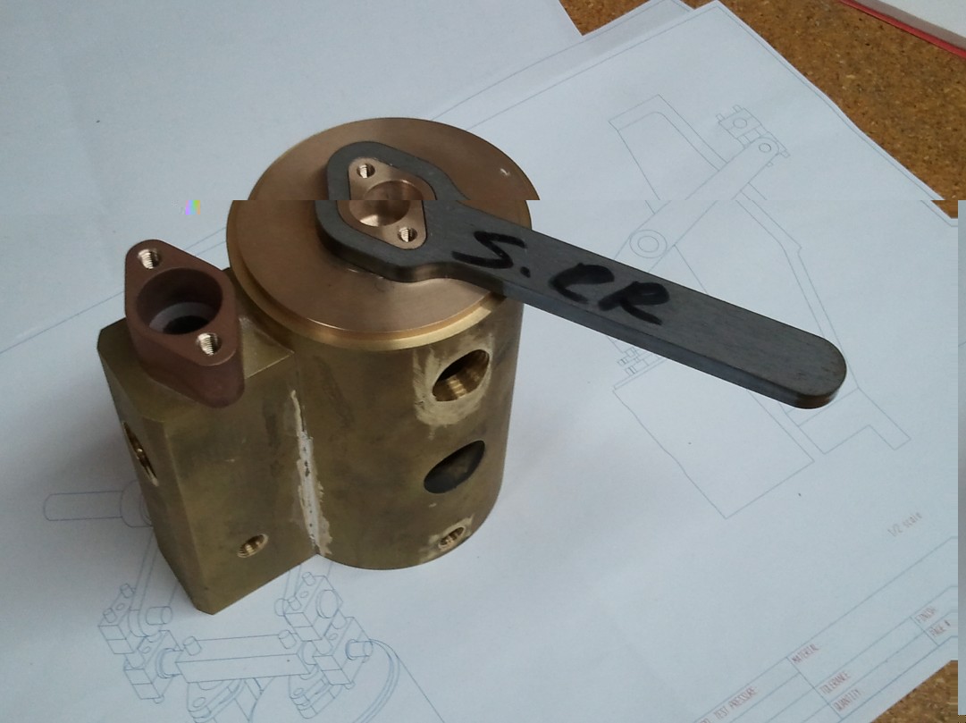

One can never have enough tools - we had this air pump head wrench made at the local laser cutter's:
2012-08-26 Air Pump Head Wrench Resize.jpg (121.05 KiB) Viewed 23930 times
