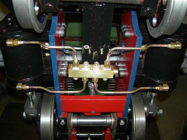

Thank you for the photos and info. As far as the drain cock manifold is concerned here are a couple of photos as it is today. Essentially it is a piece of 7/8" square brass with a 10 mm stainless steel rod through a reamed hole. A bit fiddly to make to get an accurate fit and line everything up. Still left to do is to machine grooves in the stainless between the holes to seal each cylinder from the others with O rings, but I am still waiting for these to arrive.

by Mike Rometer
I have similar drain cocks on my Locomotive and haven't found the need for intermediate 'O' rings. The steam oil and condensate is more than enough sealant.
Drain-cocks (11) (600 x 450).jpg (61.43 KiB) Viewed 20730 times

O.K., all of you experts out there. When a drain cock isn't right at the end of the cylinder but on the end of a tube, does that tube volume significantly affect the non-swept volume of the cylinder?
I suppose it depends a good deal on the relative size of the cylinder, it's existing unswept volume and the volume of the tube between the cylinder and the cock. Some engine designers have gone to considerable effort to minimize the unswept volume of cylinders.
Thoughts?

Lopez Mike wrote: Tue Dec 04, 2018 3:33 am I suppose the tube fills up with non-compressible fluids right away. All a moot point.
Given the drain tubes are uninsulated, I'm sure you're right, but it must add quite a lot to the unswept volume immediately after the cocks are closed. Perhaps that does minimal harm just when starting. The thing that occurs to me is that the drain tubes will need to be rated for full steam pressure, rather than diddly squat if the drain cocks are right by the cylinders.

by Mike Rometer
Well mine are Kunifer brake pipe so I don't envisage any pressure problems :lol:

by fredrosse
Drain passages can play a significant part in heat penalties, depending on the arrangement.
Say you have an engine running at 125 PSIG (8.7 Barg) steam pressure, with a saturation temperature of 353F (178 C), exausting at atmospheric pressure, 0 PSIG, (0 Barg) with saturation temperature of 212F (100C).
The cylinder wall, steam inlet and exhaust passages, piston, piston rod, and all surfaces in close thermal conduction contact with cylinder steam pressure will be at about the average saturation temperature between the inlet and exhaust, in this case 282F (139C).
When the high pressure steam is admitted to the cylinder, it will condense like crazy on the metal surfaces, because the heat transfer coefficient for steam condensing is tremendous. The metal surfaces are heated up perhaps just a few degrees, as the time of exposure to high pressure steam is very short, less than one stroke of the engine. This initial condensation is the basic main thermal loss in almost all reciprocating steam engines, and with typical launch engines about half of the incoming steam is condensed to liquid water, and is not available to do expansive work in the engine.
At the end of the power stroke, the exhaust valve opens, and cylinder pressure drops to atmospheric pressure, and all of that initial condensation water , thermally connected to the steam cylinder, piston, exhaust passages, etc., now boils away, this is called re-evaporation of the wet cylinder walls, passages, etc. Again with a tremendous high heat transfer coefficient, lowering cylinder temperature only a few degrees.
Parts of the cylinder drain passages that run below 212F (100C), will fill up with condensate, and the trapped water will do virtually nothing, no initial condensation on admission, no re-evaporation on exhaust stroke. However, any parts of the drain passages that run above 212F (100C), will participate in initial condensation and re-evaporation. The cylinder drain passages must at least start right at the cylinder, very hot, so the passages here contribute to initial condensation and re-evaporation. Best to have the drain passage valve seat as close to the point of inlet drain collection as possible for minimum losses here. Very small passages also helps, less area for heat transfer, and less drain passage volume to collect new condensate on every engine stroke.
