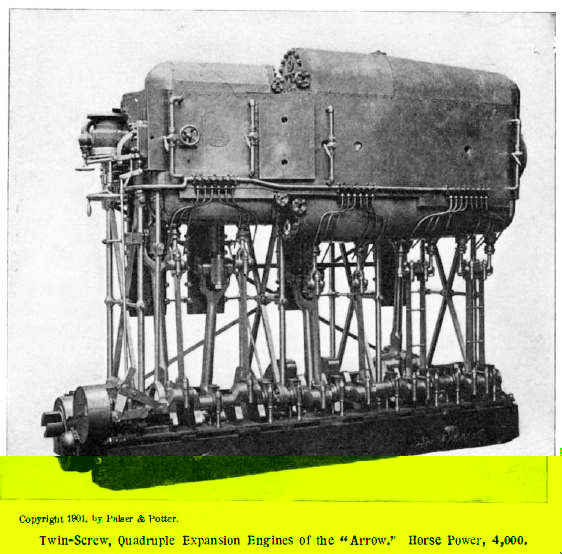

From Tom: "Also, I'm really not familiar with any applications of steam reheat on reciprocating steam engines, so that should be interesting because as far as I can tell it really isn't seen much."
Yes, while steam reheat is quite normal in the present commercial power industry, it is very rare in reciprocating steam engines. Note however that the fastest steam yacht, the "Arrow" of the very early 20th century, made 40 knots with quadruple expansion engines, 400 PSI, and with reheat between every expansion!
Scientific American, September 20, 1902
ARROW 4000HP QUAD s.jpg (50.29 KiB) Viewed 8626 times
