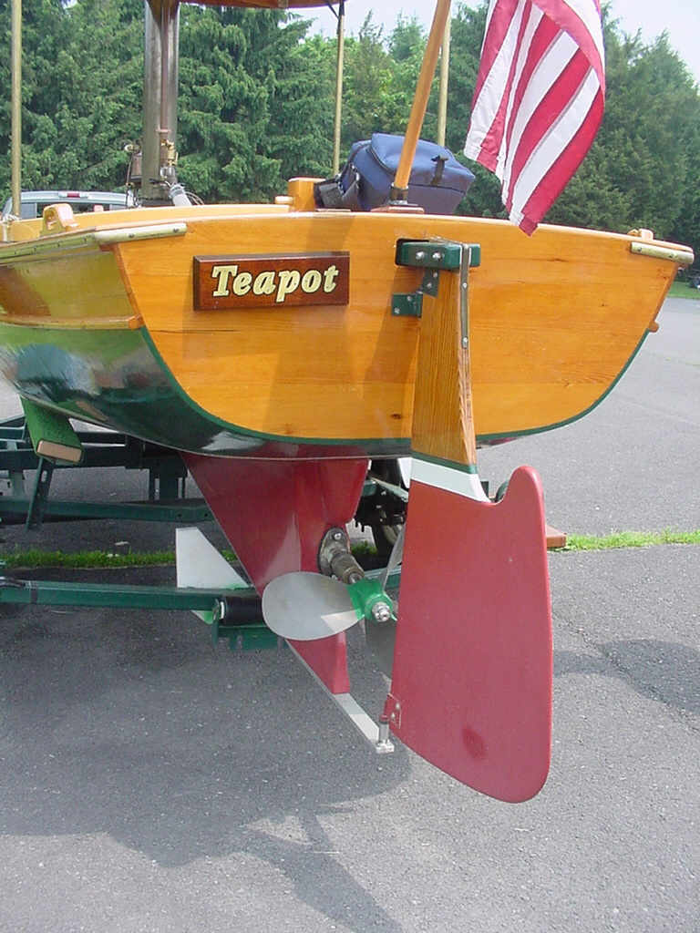

- tp stern.jpg (96.66 KiB) Viewed 13932 times
