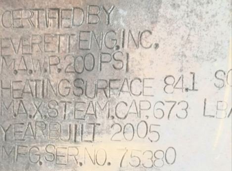

Post by Lopez Mike » Fri Dec 27, 2019 2:10 am
A 1/2' tube sheet would be fairly startling. How big is this boiler anyway!!!
If it's as much as 1/4" I'll be interested to hear. More like 3/16" I suspect.
