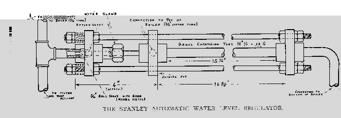

Stanley had a pretty good water automatic and it would be a good addition on our steamboats. It was just a brass tube about 15" long mounted like a gauge glass although horizontal at the desired boiler water level. Boiler water in one end, steam in the other which expanded and contracted the brass tube depending on the water level. This tube lengthening and shortening opened and closed a bypass valve. They worked very well and were used on all later model Stanley cars.

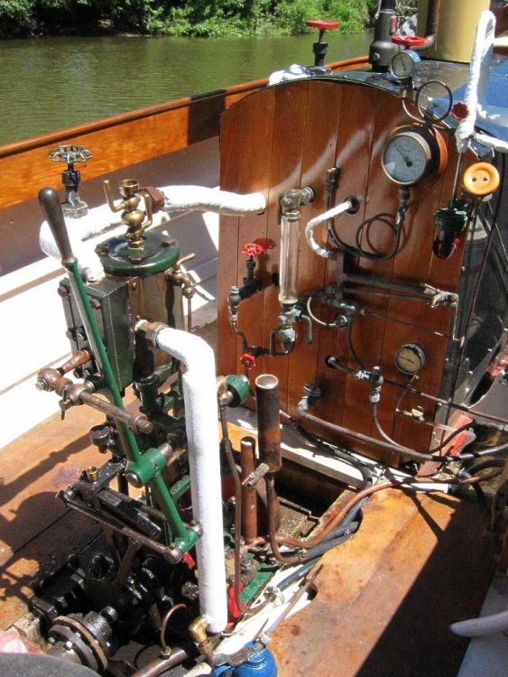

It wasn't just Stanley that used that system for automatic boiler water levels. My friend Peter Sewell had that system on his boat, visible in this picture http://www.steamboatassociation.org.uk/page-1854442 (damn link hasn't worked, follow that link then look up Bos Murphy), which worked superbly. An initial drain of the tube once in steam and then it was all go all day long. With a virtually automatic oil fire and automatic feedwater control, all you had to do was point the boat in the right direction. Apparently, although I never saw them, the big industrial boilers at Chelsea Sugar Works in Auckland had exactly the same system, just the tubes were about 6 feet long.

The Stanley Automatic Water Level regulator is widely attributed as being their design and was used on all of their later models of steam cars. Depicted in this illustration from the UK based steam car club of Great Britain. And it's a given due to its simple design and construction that it has been used by many over the years. And I'm going to be one of them.
A quick Google shows Bos Murphy was born in 1924 and Stanley closed up shop in 1929 after 35 years in the steam car business. Bos would have been 5 years old at that time, it's highly unlikely he had anything to do with the Stanley Automatic Water Level regulator other than to borrow their design later on possibly.
The Stanley twins along with George Eli Whitney and others that worked with them are responsible for most of the small mobile steam plant apparatus we use today. And many contemporary designs are a derivative of their early work. They all had numerous patents on on many aspects of small mobile steam plants.
