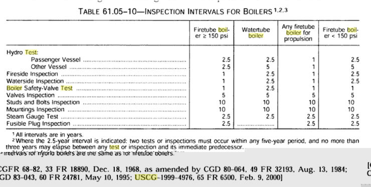

2) How often are 40ft+ / commerical steamboat boilers required to hydro by the coast guard?
See attached chart. The need for hydro is also at the USCG inspector's option, based on other inspection criteria.

- USCG Boiler Hydro.jpg (61.5 KiB) Viewed 9443 times
