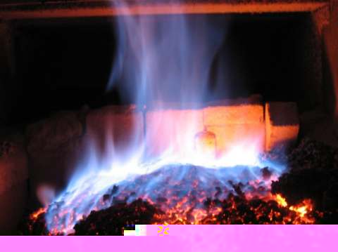

Burning Anthracite Coal, historically called "Hard Coal" or "Smokeless Coal" is very different than burning wood or Bituminous Coal ("Soft Coal"). The standard sizes of Anthracite range from the large "Stove Coal" to smaller and smaller sizes, generally used on domestic stokers with forced draft fans needed to get the small size coal to burn. On a steamboat with hand firing, larger sizes are required, but you can only get about 50% of the steam output that you can get with a wood fire or a Bituminous Coal fire.,
The railroad locomotives of a century ago generally burned Bituminous Coal, except in the large Anthracite Coal regions of northeastern Pennsylvania. The Anthracite locomotives (Typical Reading Railroad Locomotives) were made with much more furnace volume and larger grate area, because the Anthracite gives off flames which generally do not produce a fierce fire, and these flames do not have a large component of radiant heat.
The Bituminous Coals have a large component of volatile gas,which is driven out of the coal as it is heated in the furnace, and burns with large amounts of bright radiant heat output. If combustion air is not supplied properly, thick black smoke is produced, just look at almost any video of a steam locomotive and generally see much black smoke. With Anthracite fires, no visible smoke, regardless of how well the furnace and combustion air is managed.
