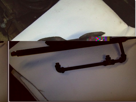

Burner looked like this:
You could make a round one w/ too much trouble if you can bend pipe in a circle after putting in the screening.
<ascii art in variable width fonts is a PITA>
I remembered after posting that I'd also welded a piece of 1" angle w/ the V pointing down to the 1/2" pipe as a flame spreader... some experimentation will be required, but the first one I made worked. Don't omit the screen - it prevents surging and shooting burning liquid out of the holes !

I have actual experience with the type of burner mentioned here. This in its original form ran for many years with success.
I have completely rebuilt the power plant of this boat & have now fired the burner several times with good results. Full flame is achieved at 5 minutes & at 10 minutes I have steam at 90 psig.
There is a pan under the burner with several rows of stove door gasket rope, you add about 4 oz of alcohol to the tray to preheat the burner. Once a little heat is present open the needle valve controlling the fuel intermittently until a vaporised burn is heard - like an old blow-torch. Then the flame can be regulated by the needle valve quite finely.
The upper pipe is 1/2" iron pipe, the lower one is 1/8" iron pipe, the jets are common brass npt plugs drilled with a no. 58 drill. The jets can be replaced or altered larger or smaller easily. The upper pipe is stuffed with copper wool from a scouring pad. I am sure screen would work. The pipe fittings are tack welded to prevent movement.
I remade the deflector to more effectively direct the flame away from the ends & up through the coils of the Blackstaffe boiler. The picture with the burner in place shows the new deflector design. For reference the boiler casing is 18" long.
The fuel system consists of two garden sprayer tanks. The starting tank carries Varsol/paint thinner to burn cleaner until everything is warmed up. The main tank carries kerosene as the primary fuel. The fuel tanks are pressurised by 2 air tanks initially at 120 psig & regulated to 15 psig. There is a 3 way selector valve to choose the tank in use or turn all off.
The hand pumps are still in the fuel tanks as a back up in case of total pressure loss.
In the mock up picture you can see a rectangular hole in the end assembly. Both ends have similar holes that supply the needed combustion air. Both holes are located so there should be no chance of wind, etc. having any effect.
The burner is held in place by a single clamp around the brass inlet fitting.

- burner new.JPG (117 KiB) Viewed 10607 times
- burner old.jpg (32.29 KiB) Viewed 10607 times
