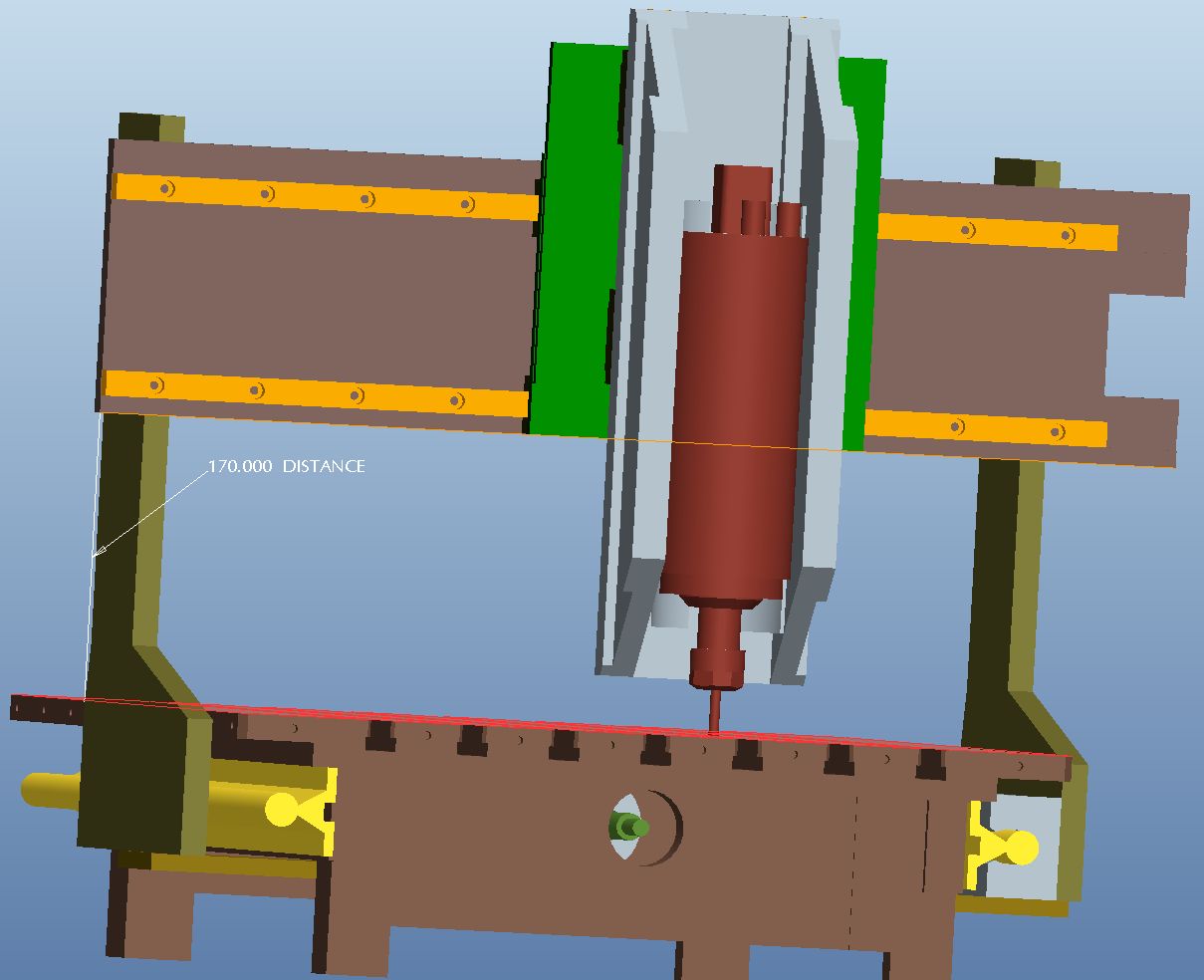

I am still rigging for the pattern making. As you have seen some pages before, I started a pattern mill project with a friend. Unfortunately he loaned me his for the cylinder patterns. So there was no need to build up my own.
But in the last weeks I started to complete my own pattern cnc mill. The Y-axis is running under the self made table already. Even with CAD design I like the "card board design validation" to get a good feeling of proportions and forth.
Distance will become 200 mm now

PatJ wrote:Nice looking CNC machine.I have seen several online that are building similar units.
Yes, this is a usual setup and nothing special. Maybe the German-Over-Engineered cast Aluminum base and the 200 mm z-travel with such a small machine makes it a little special. I don't want to bore you with this: I only wanted to show that I am still alive and still interested in steamboating ;-))

Here the actual status - I found some 100 x 100 x 10 mm angle profile in the laydown - makes it rigid...

That base is a work of art and engineering.
The angle sides look very good too.

PatJ wrote: x 450 mm (height).
The height is what makes the system week or heavy. For my patterns I am using ball nose mills with 6 or 8 mm in diameter. This are available in a length of 100 mm. take 20 mm for clamping it so you have a maximum cutting depth of 80 mm. To lift this over the workpiece surface you need additional 80 mm z-travel = 160 mm z height. with some extra I went to 200 and think this is enough. If you allow bigger diameters you can use longer tools - but all this depends on your needs...
