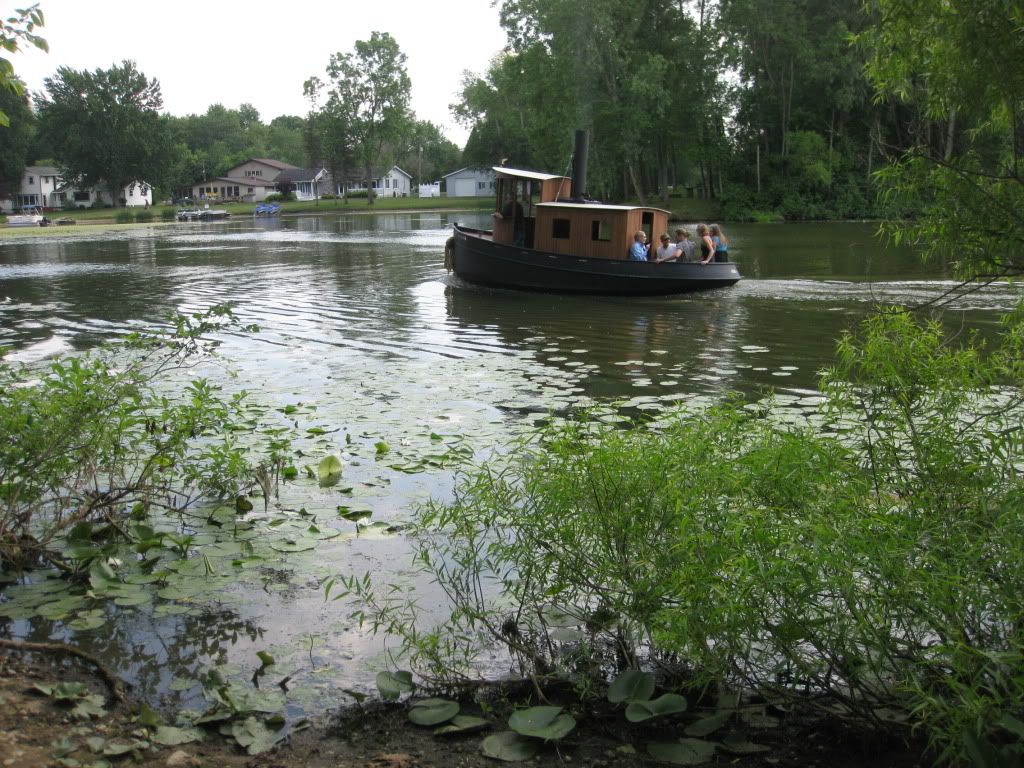

Here is Iron Chief. Very satisfied with the way she runs and handles. Bret and others helped out immensely with their steaming knowledge, so I now have a list of tweaks before the next outing. Nothing major, just insulation and a few modifications. It will run all the way down to about 6 psi. Most of the running was on 30 psi. At 100 psi leaving the dock, the whole boat would shudder, and go fast, not sure how fast, but she was moving right along
Here she is with 10 or 11 people aboard, when I looked back all I could see was heads. There were three in the wheelhouse (Man and woman sitting in the starboard door), 2 or 3 in the engine space and 5 on the aft deck. Towards the end of the trip, all the women moved to the wheelhouse, something about my feedwater heater / condenser / scalding hot shower behind the stack they didn't like

Well done Ron, glad you had a successful first steam meeting with the boat. Its definitely a big boost to actually have it operating.
One thought that i had on reading your post was the experience i've had running Zeltic at low pressures. I don't know if you use cylinder lubrication (if you haven't done, don't start), but I found that running at low pressures plays havoc with the lubrication of the slide valve. Under 50psi, and definitely under 30, the steam is so wet that it basically washes the lubrication off the valve faces. The result is that the slide valve binds to the face making the engine almost impossible to use. A simple relubing of the valve solved the problem. I've never had this problem when running at higher pressures (usually 60-100 psi). May be worth noting in the memory bank.
Interested in your hot shower issue. Have you worked out what is causing it? To my mind, the feed pump shouldn't have that much effect on the exhaust, and thus shouldn't be sending a shower up the stack. I can understand a shower on initial starting of the engine, but once underway I would expect the exhaust to remain fairly constant. Lagging will definitely help though, as the steam getting to the engine will be that much hotter. Interested to hear yours and other thoughts on this, have no experience of operating a puffer, all our boats being condensing (and even on a lake i'd go the same way).

The problem is caused by your intermittent use of the feed pump. When cool feedwater (from the lake/river in your case) indirectly encounters the exhaust steam in the feedwater heater, more of the exhaust steam is condensed and enters the "exhaust pipe". Put a steam trap at the bottom of the exhaust steam side of the heater (and discharge this over the side). Steam traps are available at most steam supply houses. As you are using exhaust steam, there is no pressure to speak of so the steam trap need not be rated for more than about 15psi. Use the shortest and straightest discharge possible!DetroiTug wrote:... Towards the end of the trip, all the women moved to the wheelhouse, something about my feedwater heater / condenser / scalding hot shower behind the stack they didn't likeThe exhaust manifold needs a drain. It belches a half cup er so of water every few minutes when the feedpump is engaged.

Ron, Yes that is what is happening. It was so much water at one point, I thought the feedwater heater was leaking. At the dock I closed the feedwater valve at the boiler and rocked the engine over with the bypass closed and the heater coil held pressure (110 psi) just fine, so that proved it was simply condensate. On the plus side, the feedwater heater works great, as the condensate is evidence of the heat transfer. The line coming out is too hot to touch. Thats one of the things fighting me on steam pressure, the water lands on the top tube sheet and and cools the boiler, only thing worse would be a block of ice.
Daniel, There didn't seem to be any lubrication problems, the engine ran great with oil in the steam line.
