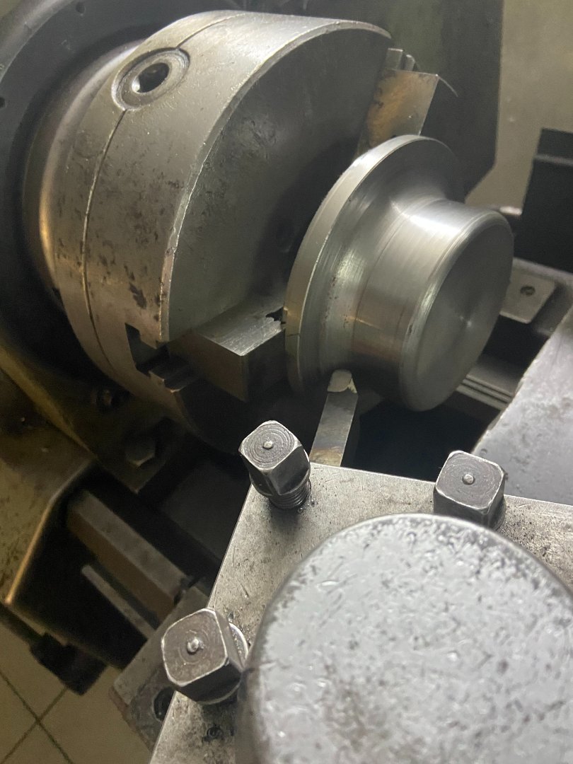

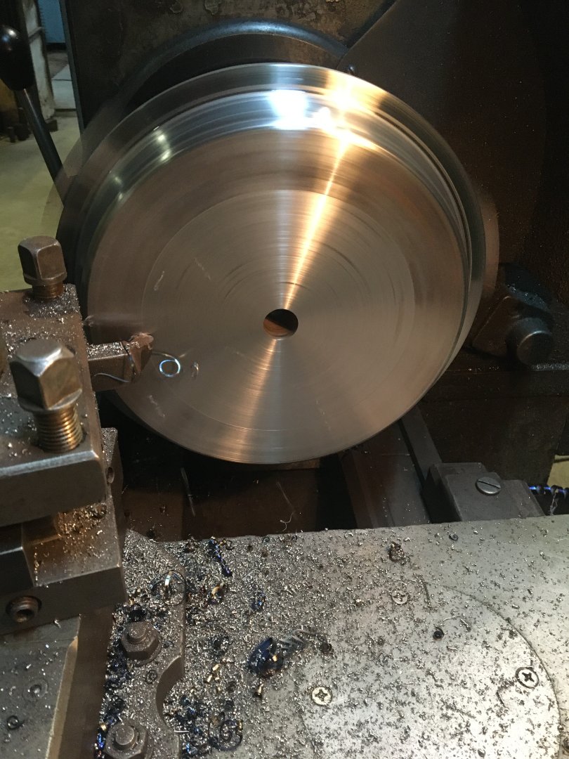

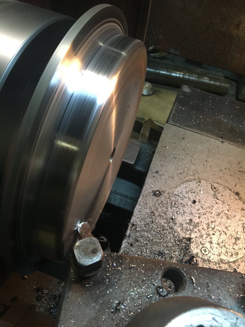

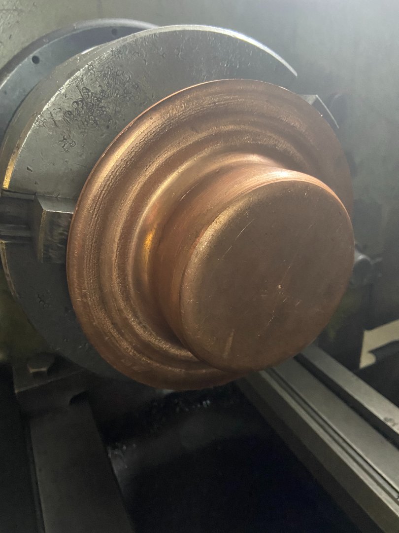

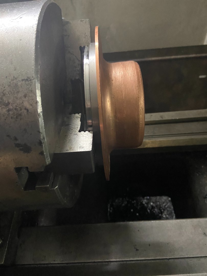

I hand to make the roll mold on a 10-inch lathe in my good friend workshop.The copper bottoms (covers) of the condenser were pressed out by my friend on a lathe lathe - 20 inches. I don t hav such a big machine. For normal operation of the condenser, a high-power water pump will be required, more than 100 liters of water per minute.

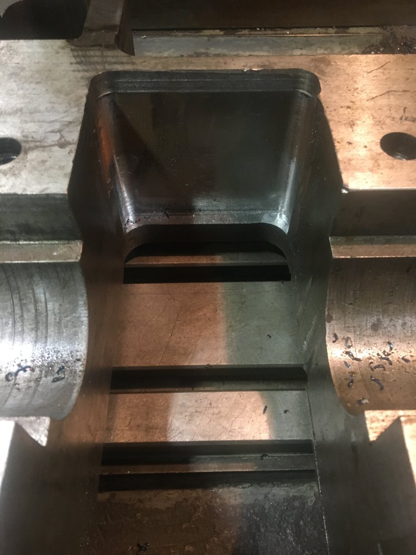

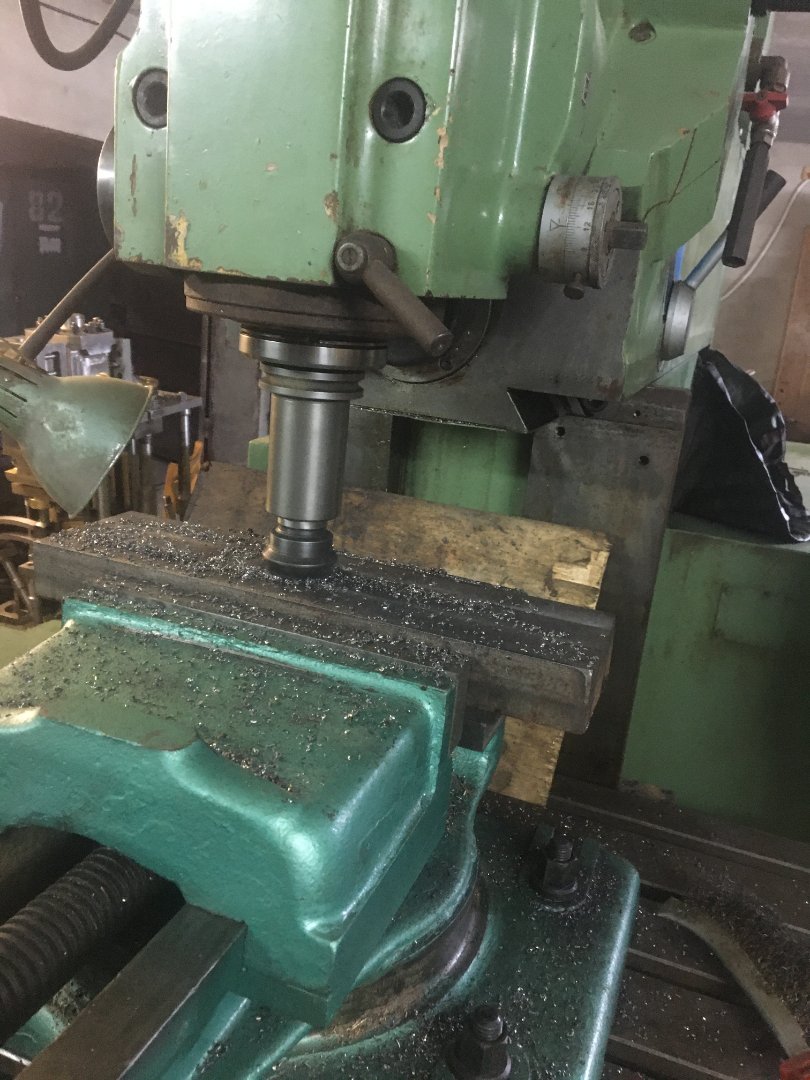

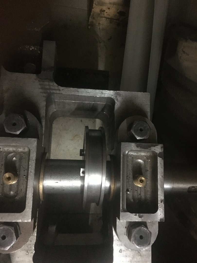

Dear Pete! I have to work on machines whose accuracy is not more than 0,025-0,03 mm. Accuracy 0, 01 mm. achieved only on the most critical parts - crankshaft diameter, cylinder diameter, diameter piston road, etc. i don t use the 3D CAD (On Shape Free) program yet, I m just about to learn it.Here, where I live,laser work is carried out on thin sheets of metal. So I have to mill. Here are some photos of the final work on the car frame. there was a slight inaccuracy in the design that had to be corrected. Ingvar.

Photos of the final work on the engine frame

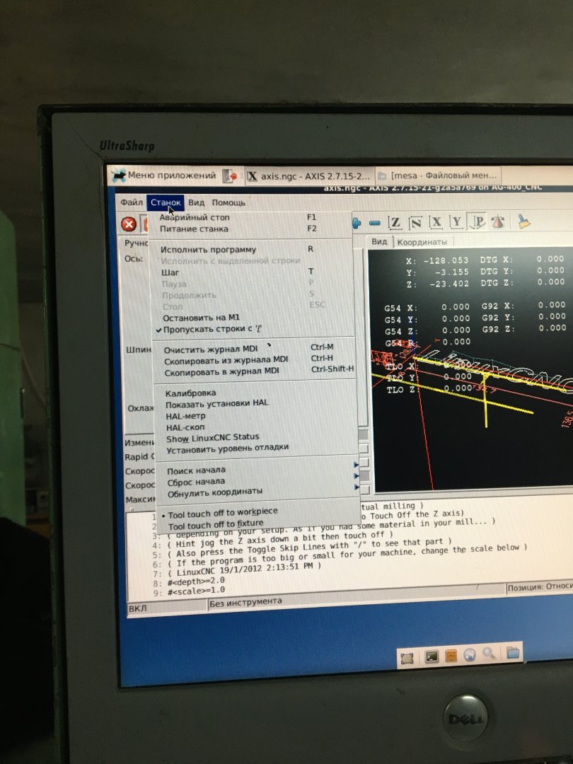

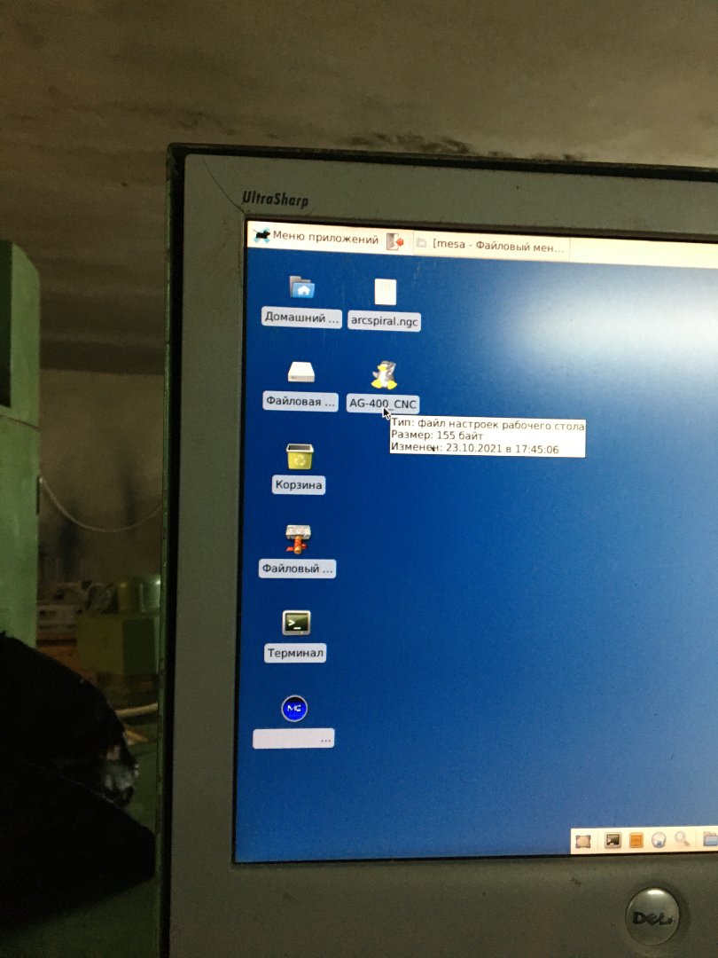

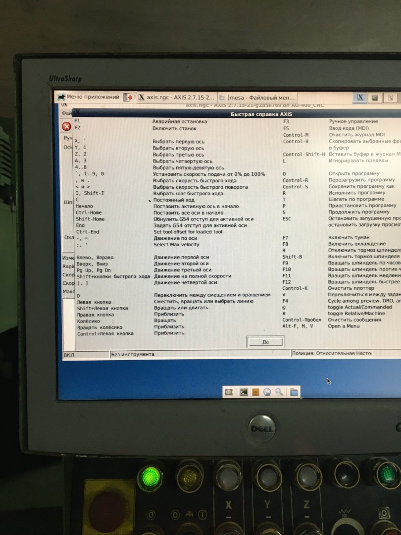

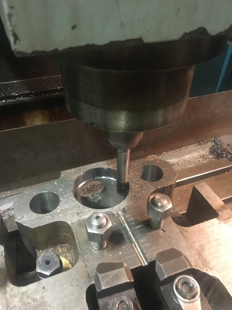

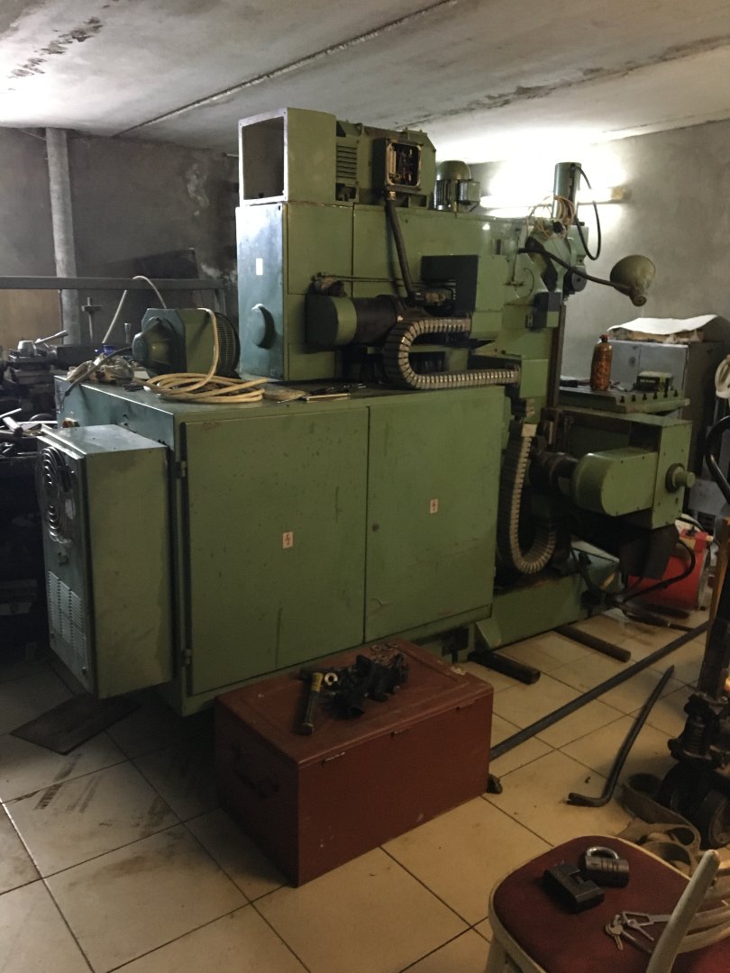

Hello Pete! Thank you for the information. Bat at the moment I need to master the Linux CNC program. A year and a half ago I purchased an AG-400 CNC machine? a photo of which find attached.

Hello Pete! The Linux CNC program is already installed on this machine? it is simple and I can learn it quickly. I*ve been putting the machine in order for a year. I hope to show you photos of its work soon.
