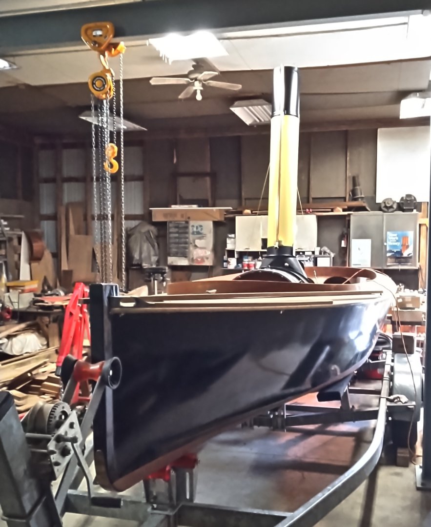

Posts: 356
Boat Name: SL Iona
Re: My 24' Launch
Post by S. Weaver »
KIMG0134 (2).JPG (136.92 KiB) Viewed 70447 times
A shot with the boiler in the boat, secured to its mounts, with stack and bronze stays in place (Stack easily removes for transport or low clearance.) Now on to insulation, applying the jacketing, and boiler piping. The oak coaming and other trim on the foredeck is waiting to the last so I don't scratch it up. Apologize for the "quality" of the device image.
Re: My 24' Launch
Looking mighty fine!
