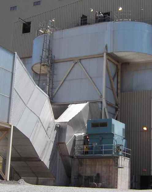

In the utility industry, large fans are used to push around the stack gasses from coal fired boilers. The US industry specifies ordinary ring oiled sleeve bearings for almost all of these fans, be they centrifugal type or axial type.
For the axial fans, the normal manufacturer's practice is to use roller type bearings, these can take higher loads, but need to be replaced every 5 years or so. In the US we even specify sleeve type bearings for the large axial fans, ranging up to about 15,000 horsepower, 900 RPM machines. That is because the sleeve type bearings will typically last for 40 or 50 years without replacement.
The fan manufacturers manage to modify their standard designs to use sleeve type bearings to get sales in the US.
10,000 Horsepower Hot Gas Fan on a 600 Million Watt Coal Fired Power Plant - Babbit Bearings
ID Fan 10000HP.jpg (23.2 KiB) Viewed 11422 times
