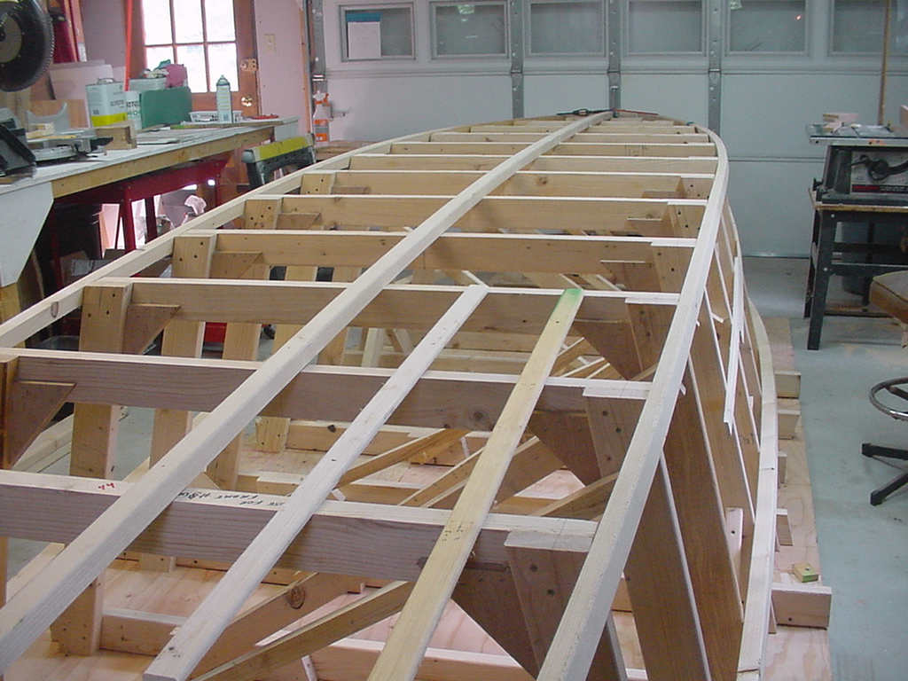

Went shopping for 20 foot long (6 Meter) lumber today, for the chines. Found some, we had to rip several pieces to get something clean enough for the chines. They had clear Cedar 2x4, 20 ft long, but they are $74 US each! The Cedar is too soft anyway.
Now to cut the frames to receive the chine logs, 1-1/2 x 1-1/2 Douglas Fir chines.
- Framing 06Aug2010
- BoatFrames6Aug2010b.jpg (91.68 KiB) Viewed 45674 times

Merenti is a great wood for chines and keels....it's sold as decking.
Watch for wind shakes......
Dave
Dave
